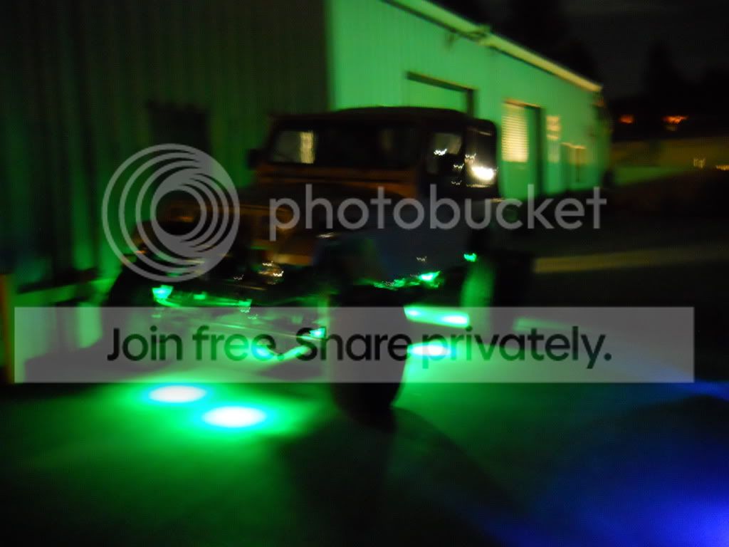

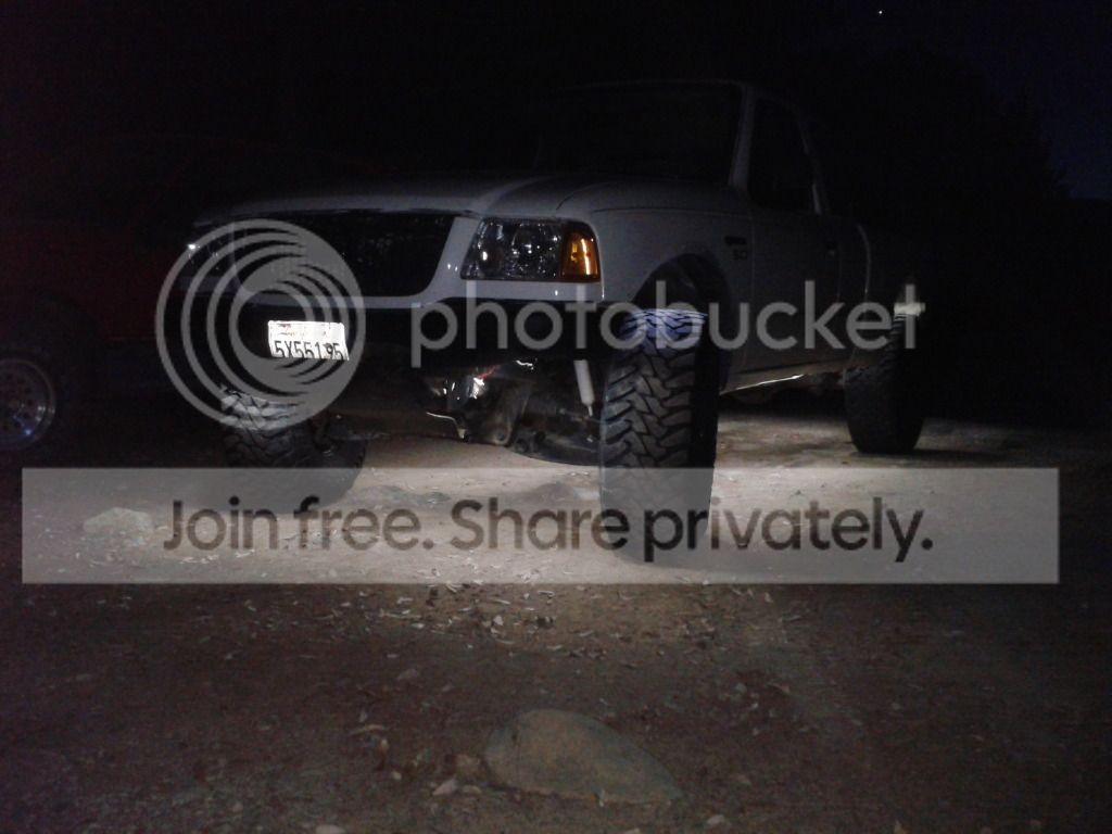

visionx trantrum in blue
Rock & Utility Light Tech
in green

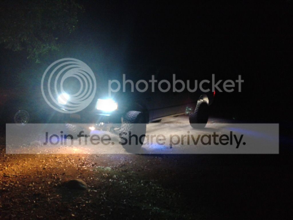

and my new rock lights i got from http://www.horsepowerjuice.com/led-lights/rocklights.html

the tantrum lights from visionx dont really work for rock lights they just look cool. the lights from horsepower juice kick ass. for $35 you get 20 of them and they are bright and have very little power draw.
