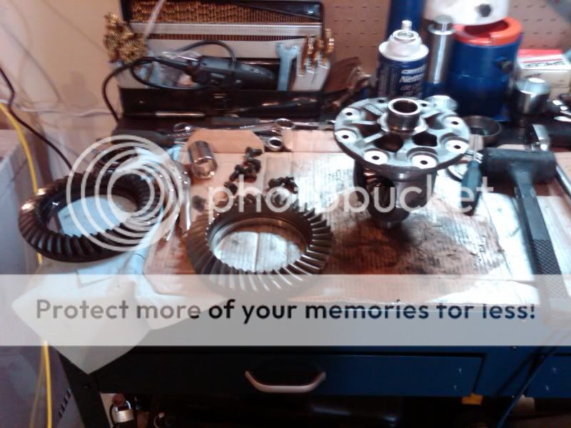

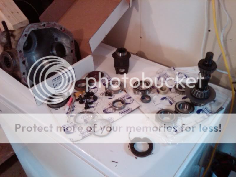

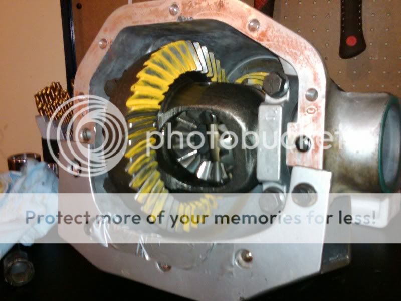

here are a couple random pics from my gear install.

looks like you have a bit of uneven gear contact there. Better get that worked out or it will make noise quick.
lol no there is not noise whatsoever, those gears have since had ~5000 km on them. That was a quick pic in the middle of my setup just to show the jig I used to simplify the process. I have done a number of gear installs, all with ZERO noise and/or problems. That was not final pattern OBVIOUSLY.
