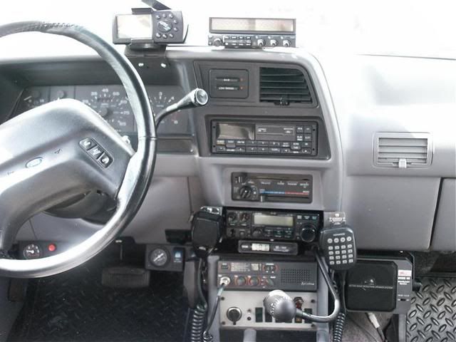

If the dash looks like this one:
New system for the old mule...( 1989 Bronco II )
Then you don't have to remove any part of the dash. you need either a set of removal tools, or bend a thick coat hanger into 2 U-shaped pieces. Slide the tools into the four holes on the front of the radio, and pull the radio out. It may take some serious wiggling and pulling to finally get it out, but be patient.
Sorry, I forgot to add that the existing junk is an aftermarket Jenson piece of
crap. It looks like they just slid it in where the factory one was but I'm not sure.... Thanks for any help on this
does your dash look like the one in the picture exbass posted? if it is, then youll need to find a dash installation kit. thats assuming your going with a single din stereo.
