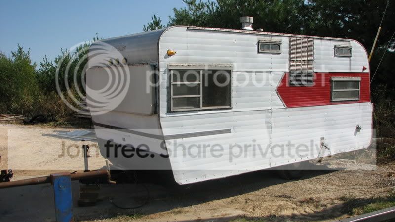

i have a 1964 driftwood camper thats 15ft but its so heavy its a pain in the ass to haul with the ranger

i have a 1964 driftwood camper thats 15ft................
Truck-Bed-Trailer-Camper
That thing is cool as hell, I love old "retro" campers and want one to pull behind my '64 International project, that is, if I ever get the money to actually get 'er goin'......:c-n: Sorry for the thread jack!
