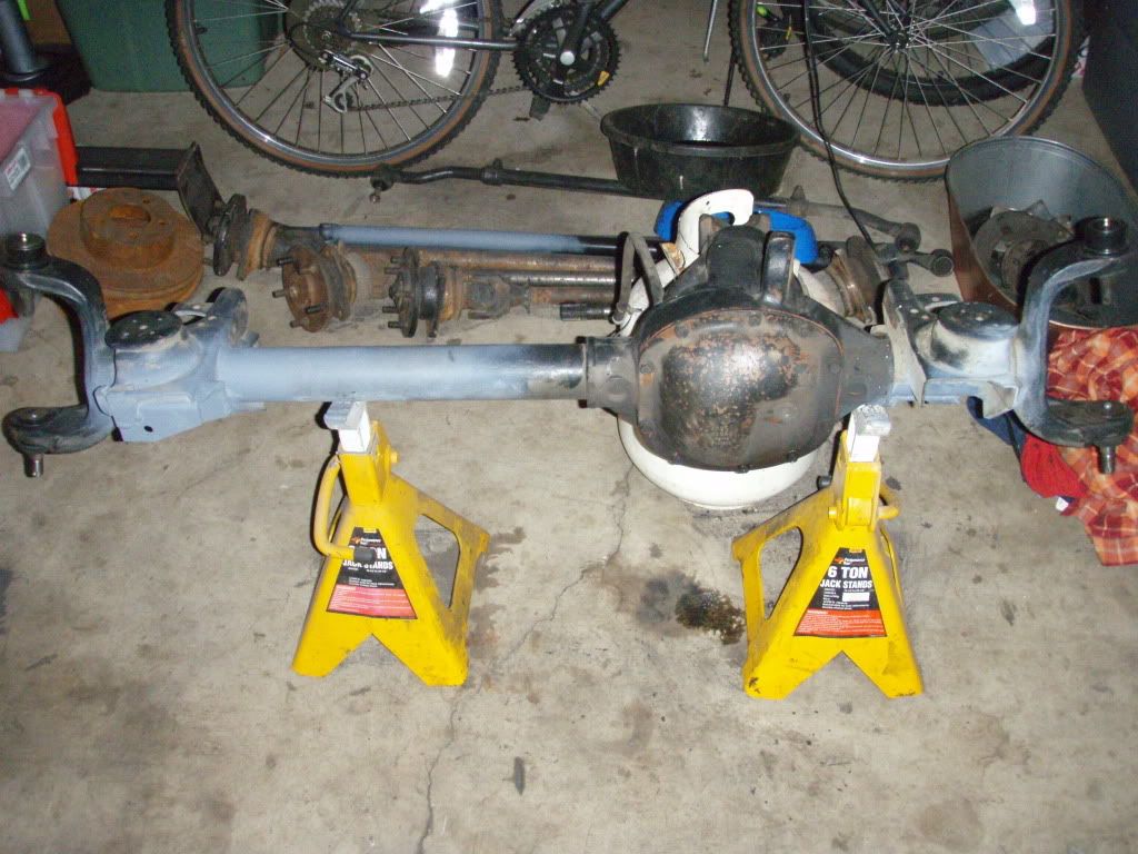

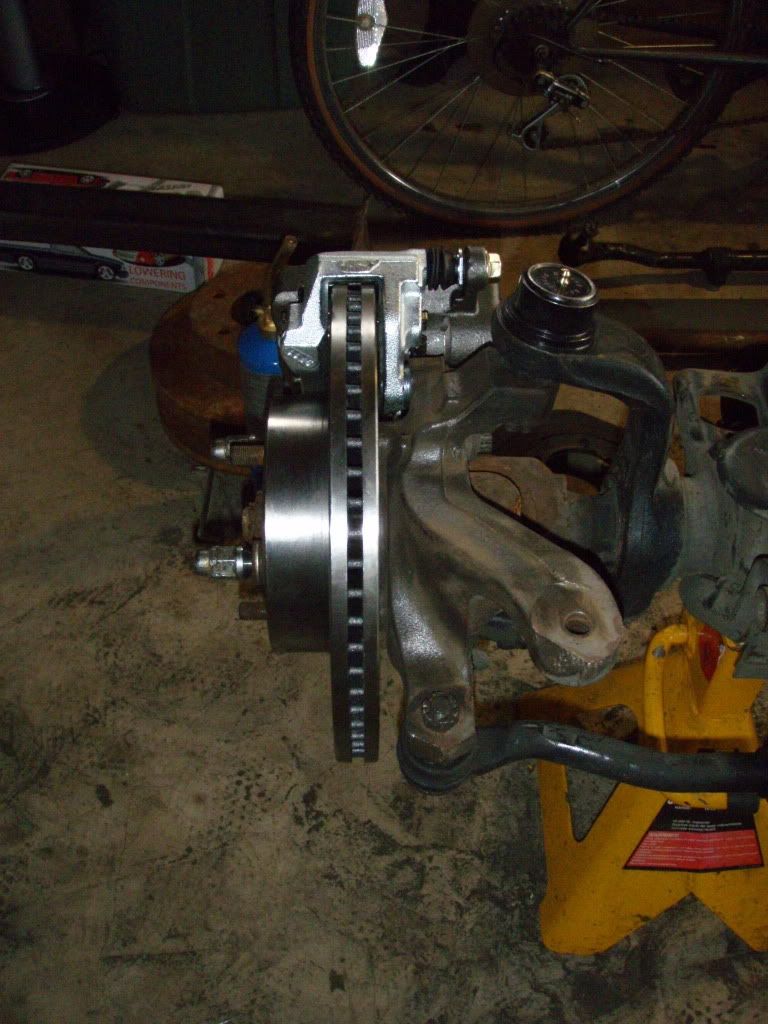

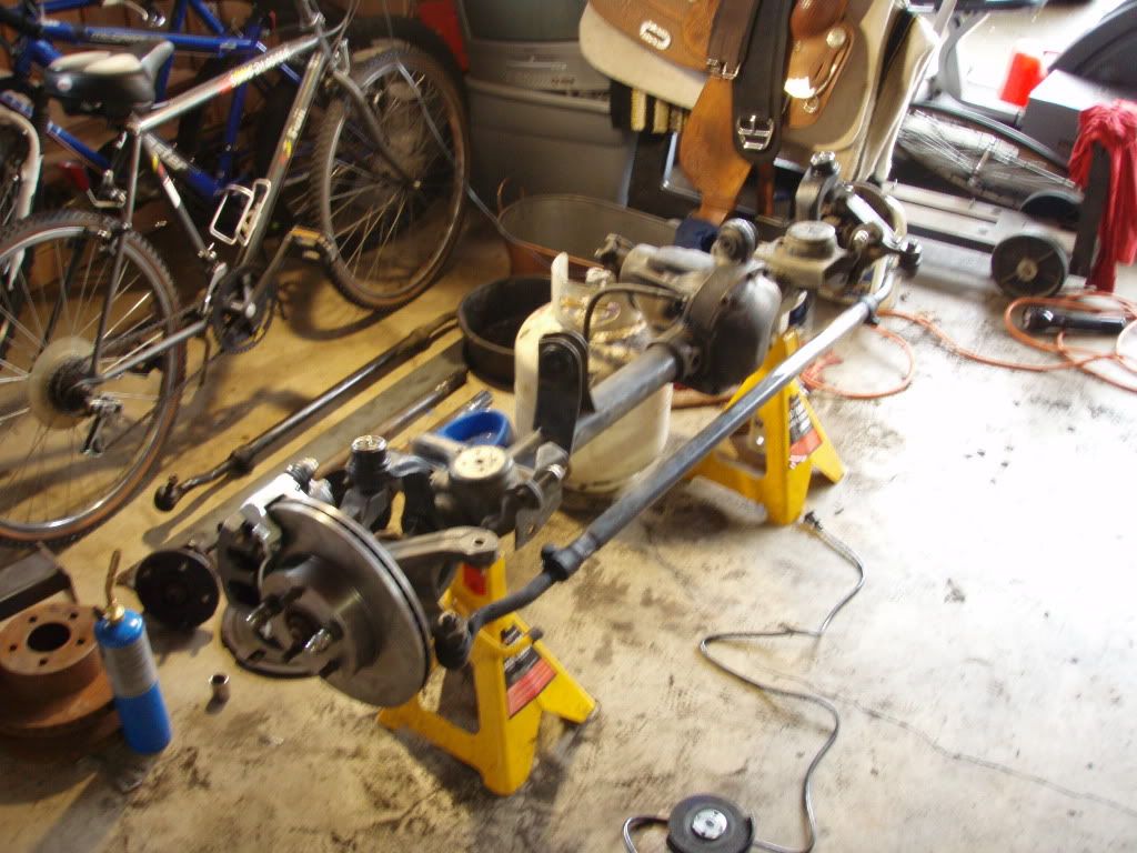

starting the SAS in two weeks once the rest of the 3 link parts show up. got most of the extra brackets grinded off and cleaned up on the axle.
im going to be running a HP d30 out of a 98 cherokee.
760x full clip u joints
99 WJ knuckles swap for cross over steering
cut, sleeved and shortened WJ tierod and drag link
03 WJ akebono big brake swap w/ dual piston calipers
02 sporttrac 4wd rotors
4 series carrier w/ 4.56s and an Aussie
3 linked with creeper joints on lower links at the frame.
adjustable DS upper link.
2 inch .250 wall DOM for upper and lowers.
new tranny crossmember
RS9000XL shocks up front.
7 inch EB coils
the dana 30 will be perfect for what i do. driving to college, work and in the snow every weekend at Mt. Hood. i wanted to keep it stock width, same bolt pattern and improve my terrible steering i have right now. its my DD so i need it to handle well on the road for the most part.
i know people hate mad hard on the dana 30 but i know it will suit my needs very well so thats why i went with this setup. my only concern was the stock brakes using smaller rotors and a single piston calipers so i addressed that issue accordingly.
