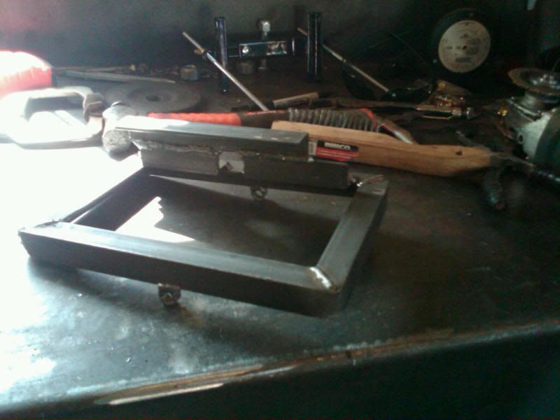

Long story short, I have a 9000lb winch coming Tuesday! super pumped. The current electrical system isnt going to cut it so duals it is...
...no pics yet...picked up everything i needed to do it.

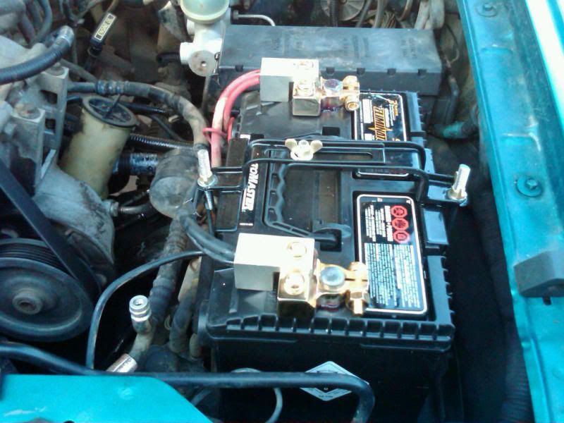

The list is as follows:
- 2 motomaster eliminator 875 CCA batteries
- 13 ft 1/0 welding cable
- 4 gold plated terminals
- termination lugs

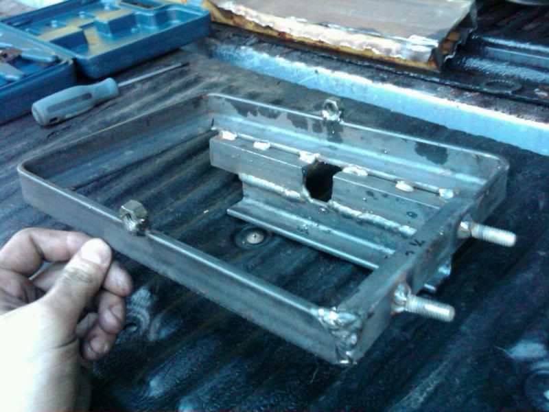

- 3 feet angle iron ( for aux battery tray)
- 2 sets battery hold-downs (original batt has no hold down ?!)
- may have forgot a few misc. things.
Im getting at it tomorrow, while simultaneously helping my buddy do an SAS on his toyota (dual t-cases, dual lockers, 37 irocs).
I will be wiring them in parallel, with NO isolator. I am doing this purposefully to avoid the hassle, and it doesnt much matter anyways, as I never plan on using the winch (to a great extent) without the engine running.
Ill post some pics tomorrow hopefully, as long as everything goes well
wish me luck!
