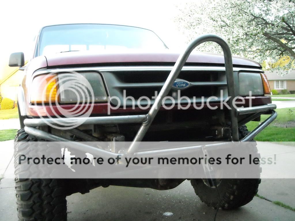

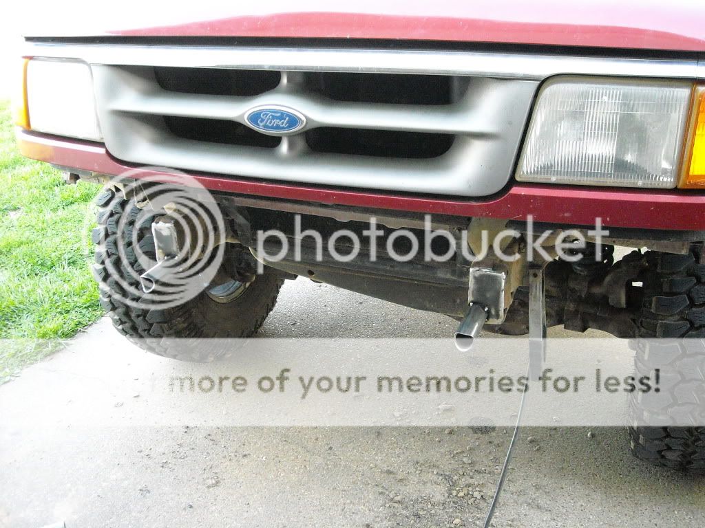

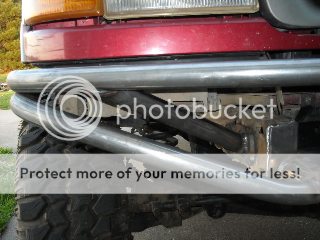

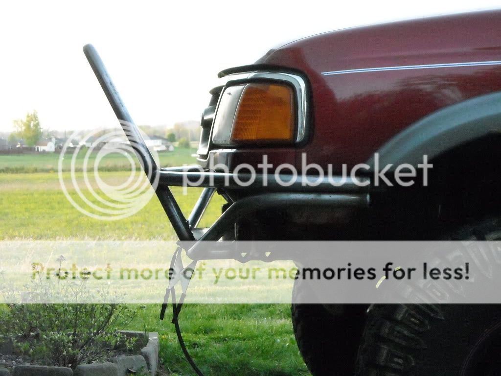

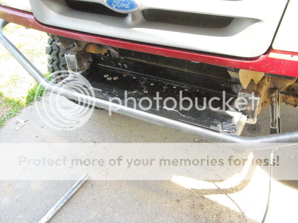

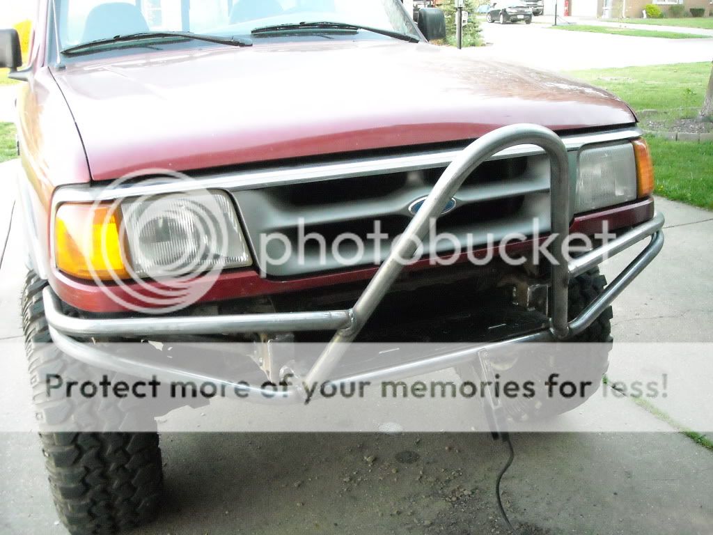

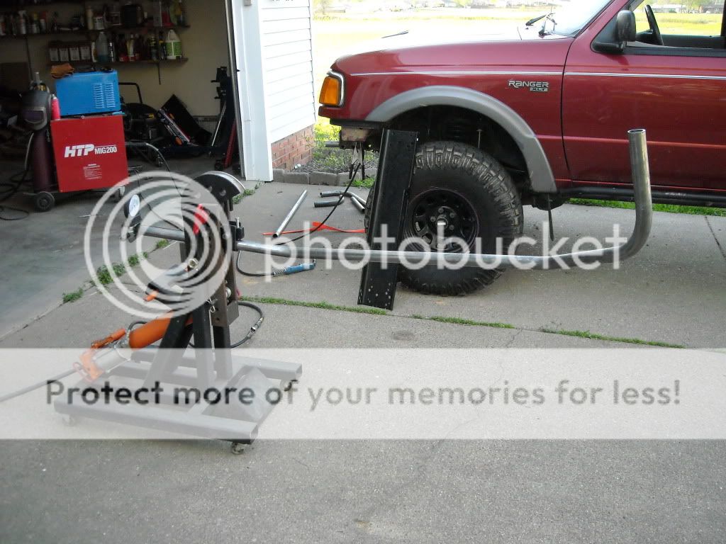

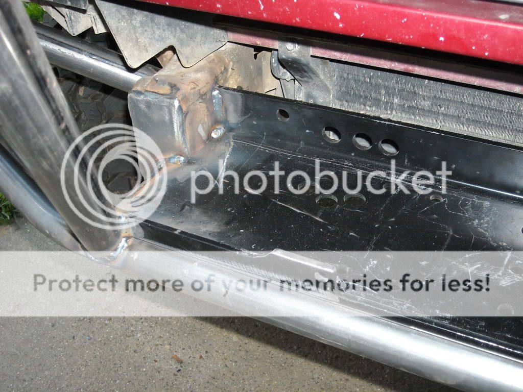

Did some work this weekend.
Plated end of frame with 1/4"
Front tube winch mount bumper

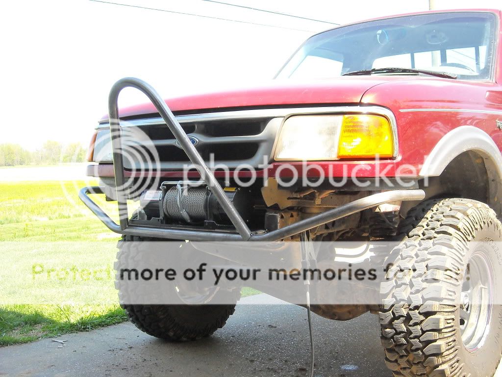

Cut the Harbor Freight winch plate to fit.
Looks good. I like it a lot in fact. :icon_thumby:
looks good. wana make me one?
GEEEEE......Greg you were a busy boy this weekend... :icon_thumby::icon_thumby::icon_thumby:
looks really good.....can't wait to see ya use it.....
only one little suggestion....maybe a brace running at about a 45 degree angle from the front of the frame horn to where the upper tube meets the stinger.....
and does the fairlead interfere with the bottom tube???
also, love your bender base....that is cool :icon_thumby::icon_thumby::icon_thumby:
l8r, John
turned out good greg...ours will be pretty similer....is that 1.5?
Would if I had time.
l8r, John
I'm going to add more to it but ran out of time for now. I made that bender about 4 years ago.
!.5" HREW
Thanks and glad you guys like it.

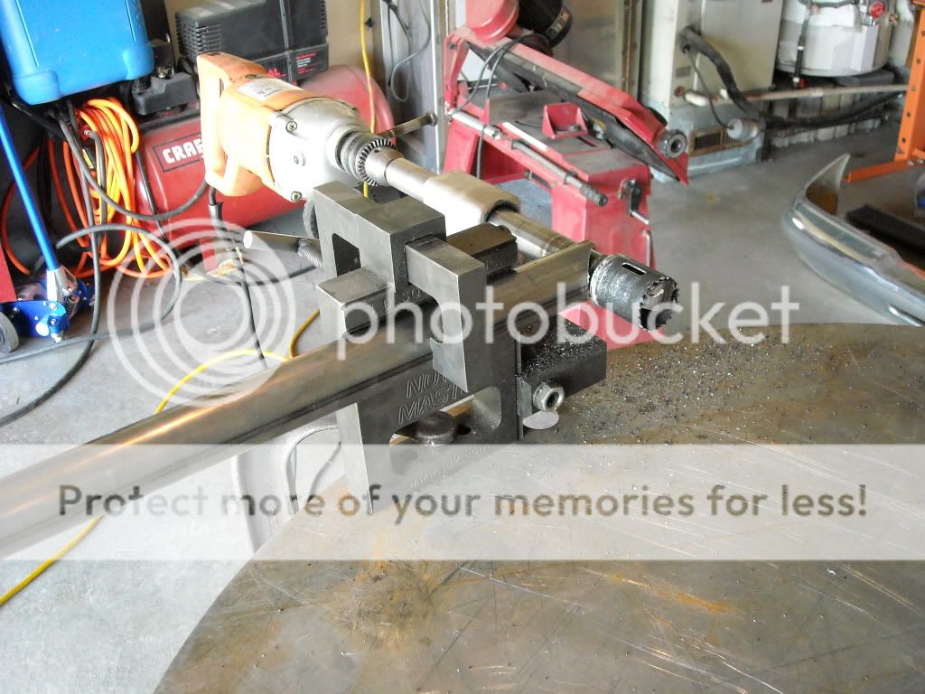

nice progress, what tube bender is that? are you happy with it?
Looks good! I'm with SPD, what about that bender? What size diameter does it do and do you like it?
hmm i love it. guess i should start thinking a bit more about building my own bumpers now
does the plans include where or what A/H jack to buy?
what all did you change if you don't mind me asking, i did notice the four caster wheels. anything else?
You're going to love that winch. I have the same one and it's got some serious balls.

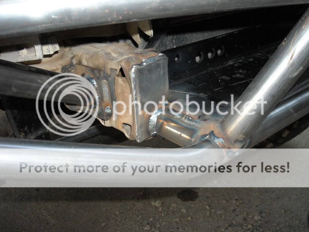

Looks good. I just have always wondered why people do a full weld on tube bumper. It's gonna be a pain to paint and a pain to fix it you bend it.
It's the harbor freight air over one. Don't really remember what all I changed, it's just slightly different .
Thanks. They're slow but work good . I've done bolt and weld on bumpers and I prefer weld on. Maybe I'll Post some of my other work.
