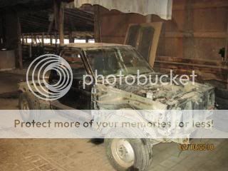

I thought I would share my build of my '91 stx ranger. This is my first attempt at anything this involved. This is condensed, copied and pasted from FordRanger.net. Thanks to everyone [especially sloue] at FR.net If you have suggestions or comments, please feel free to post them here or there as I learn along the way. I hope this will inspire others to try to build their own.

. Hey, I thought I would show my lack of knowledge. I haven't taken a real close look but it seems the fenders and rad support are welded to the cab.I need to know if I can get rid of some or all of the inner fender? I need to lose as much weight as I can
remove box; 2 hrs
. I guess its just a badge and/or a trim package after '87/'88, who knows?
. total time - 12.5 hrs, wd-40 cost $5.00
Live and learn.
I tried a zip disc, it sorta worked.
