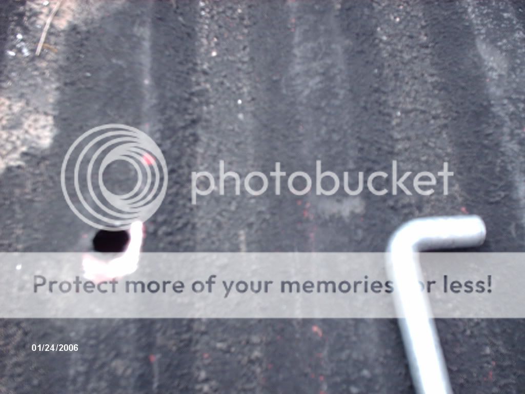

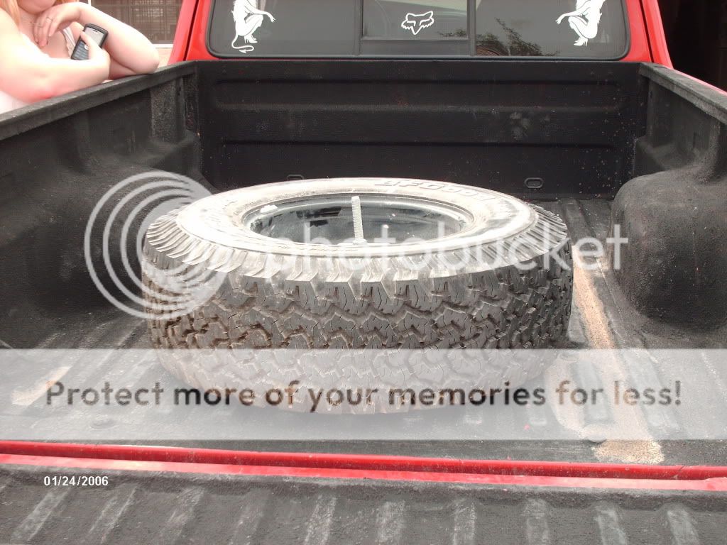

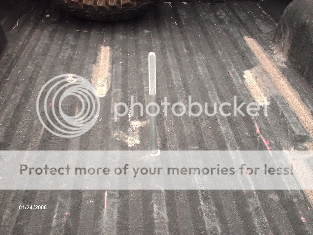

Well i was bored the other day and since i have 31s on the truck i knew it wouldn't fit in the under bed carrier and living in las vegas i didn't wanna just lay it in my bed letting anyone go ahead and take it. sooooooo abit of drilling a 5/8thsx16in(shoulda gotten the 12in.) anchorbolt and look at that now i just need a way to lock it and i'm good:icon_thumby: cost all of 4 bucks woohoo!

so now i can still take it out and put my quad back there but also have my spare not sitting in my garage when i might need it. and yes my camera date is wrong........
whatever plate you have centered on the bolt to hold the wheel down, drill a hole in it that will line up with one of the holes in the wheel and put in a bicycle lock. or switch to a 12in eye bolt and use a cable through it and the wheel lug hole and lock it down that way. just a thought.
yea i gotta wait for the drill to charge though.......waitin to find my charger haha.
