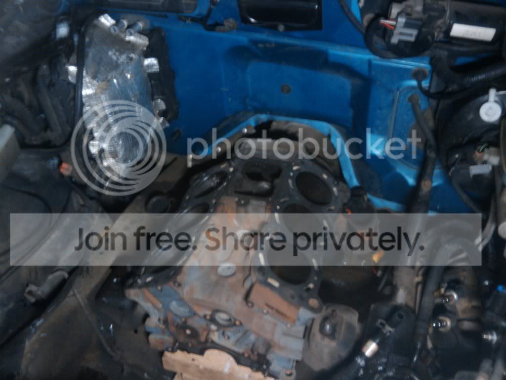

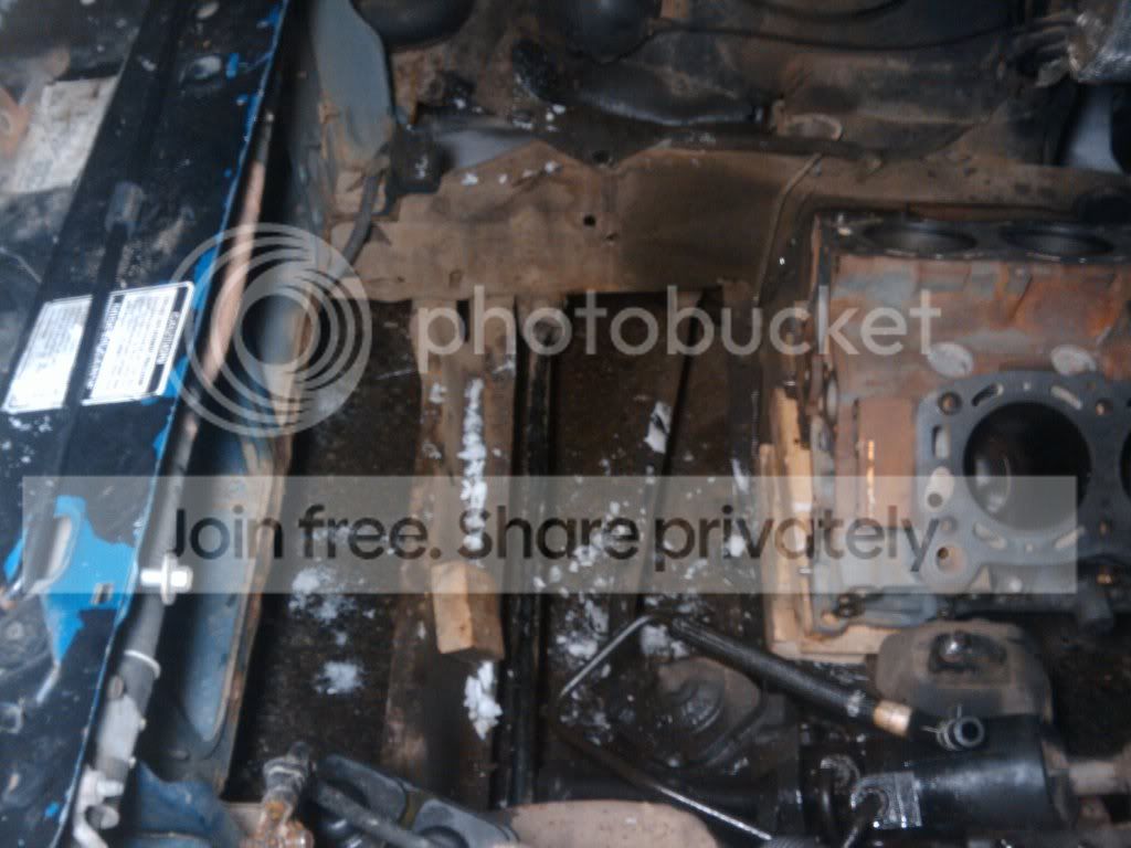

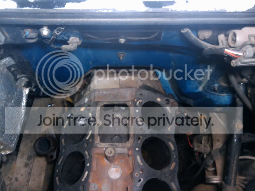

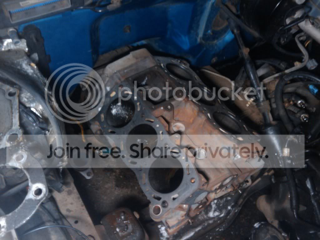

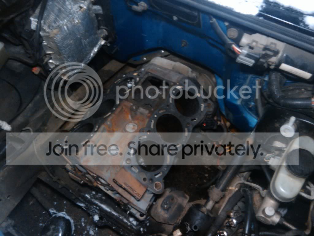

Here's some pics of a spare SHO block bolted to the tranny. There's TONS of room in front of the motor, the SHO engine is actually shorter than the Vulcan, it has a much more compact accessory setup. I'll be going with an electric fan on the rad (what works well?). No AC on this truck, not needed up in Canada.

Cool project!
Can I just move the tranny crossmember forward 2-4 inches, lengthen driveshaft, bend shifter a bit more, and be done with it? Does anyone have a different solution?
That sounds like the easiest way to me.
As for the driveshaft, I would just lengthen the one you have now.

If the oil pan will clear the crossmember and you have enough room for the exhaust still, I'd say go for it! and move'r up a few inches.
Didn't think of oilpan clearance...that's why I'm here, thanks for the advice. Exhaust has lots of room.

Did some work on it tonight. Modified the crossmember (I F$%ing hate the bolts that attach the crossmember to the frame!) to locate the tranny/engine forward 3 inches while keeping the same mounting points for the crossmember on the frame. Turns out I run out of starter clearance when I do this. I threw a spare pair of heads on and the intake to see if I could move it back at all, and I have about an inch to spare, and that should fix the starter problem.
I'd like to get the crossmember finished up tomorrow, and maybe a start on engine mounts. I've only got a few hours between work and sunset, it seems to go by really fast.
As for trannies, only the 3.0 Ranger/Mazda tranny will work. Strengthwise, it might be slightly inferior to the T5, but that's debatable (at least stock for stock). The Aerostar bellhousing is impossible to find, and even if you do, you still need an adapter plate, so I don't know why they're so desired. I'd like to just make an adapter plate to the Mod motor pattern or the 5.0 pattern, opens up a lot more trannies, but that's a future project. I'm sure the M5OD will last fine for now, and if not I can swap one in a few hours.
PS - You can see 2 of my 3 SHOs in the backgrounds of these pictures. I think I need an intervention.
Looking good. First time I've seen a truck where the motor was the only clean part.
