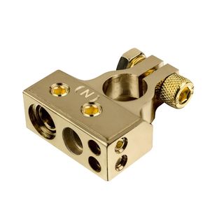

I want to change out the battery wires and the battery terminals on my 96 ranger.. I bought and used the Scosche High Power Gold Battery Terminal and let me tell you i had so many problems... I would go to the store and shut my truck off and then come back and start the truck back up and all i would hear is click and then i would have to go over and move the terminals and then it would start right up.. Don't matter how many times i would clean the terminals and then remount and wait a while and then it would happen again...So i got rid of them and now i want new ones and i not sure if the marines ones wing nut won't come off or if the Tsunami 24K gold plated battery block terminal where any good .. So my question would be which one to get and won't give me and shit and has anyone used the
24K gold plated negative battery block terminal before??? I am also running offroad lights and hope pretty soon a winch or more offroad light..

AUTOZONE
Price -$14.99

audio terminal ...These 4 Wire Gold Battery terminals will accept one 2GA , 4GA cables and two 8G cables Positive

You don't need $16 MIL-SPEC terminals, gold plated bling or any of that other silly shit.
Get standard cable/terminals and a set of treated felt washers: clean the battery posts with corrosion remover, rinse, clean again, rinse again and install the washers, then the terminals. Coat the whole assembly in battery connection sealant (the red spray) a time or two, and ANY time you break the sealed connection, re-seal it. Keep the top of the battery clean to keep the corrosion down.
That's all you need to do. Period. If you want longer bolts to add more connections, do that, just make sure they and the nuts are stainless.
I've experimented with several different battery terminals but never tried any of the gold plated fancy ones.
