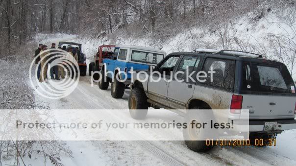

Wow never seen that type of steering setup before on a Ford TTB suspension, do you like it? What are the advantages? Does it work well? Sure does look cool...
Last pic? Looks a lot like the setup Snowthrower made awhile back out of three passengerside stock links (welding the eye of one onto another, then the 3rd was the tierod to the driverside. Can't seem to find any past threads on it though... I wonder if it was before the big forum fiasco back in '07 and it all got lost :bawling: ). It worked excellent as far as keeping the suspension in check, but still had some bumpsteer because the pitman arm itself was still out of line from the axle pivots.
Looks like you still had the misaligned steering in most of those pics. Did it feel funny at all when climbing those hills? :icon_twisted:
Yes that is the prototype steering I'm testing. It works very well to be such a simple system when ran with a drop pitman arm. The pitman arm is approx. 1" above the pivot bolt on driver's side, the link is directly in front of the pivot bolt on pass. side. No more limit straps on the front to hold it down. Been driving for 3 days now with no problems. Haven't noticed much bumpsteer.
Didn't notice too much when in 4wd with the old setup. It seemed to help with the frontend pulling to keep it in check. The pix make it look a lot worse than it is.

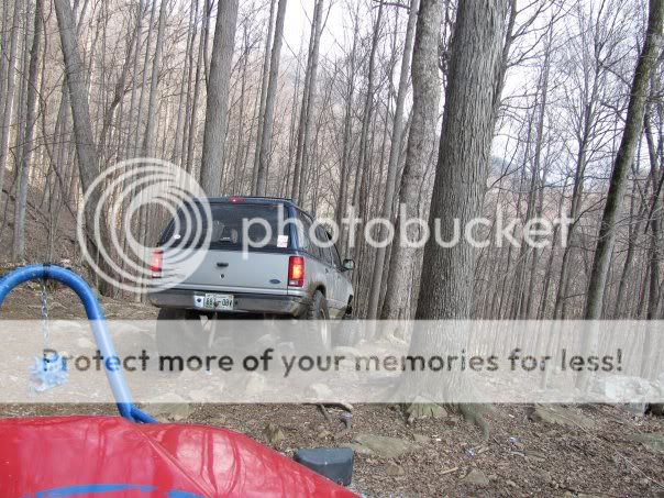

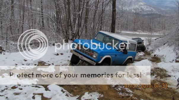

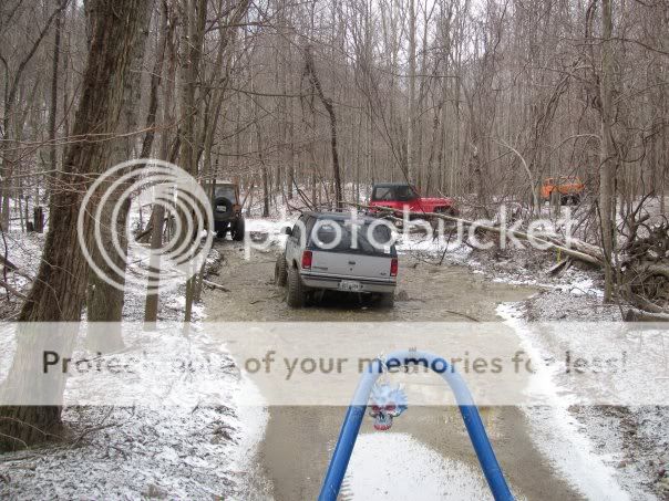

All the wheeling pix were taken at Windrock. I broke down and bought a season pass since I only live 7 miles from it so I will be wheeling there often. First 3 or 4 pix were trail 13 which I highly recommend, we rode that trail for several hours and I got a few new dents because of it. Others were Lil' Schoolbus (steep hill & flop on side) and trail 10, last two were next door to guy that done the steering so we could check for interference.
