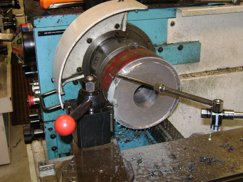

I got a few pics of the little progress I've made on making the adaptors.
Project Apple Bottom

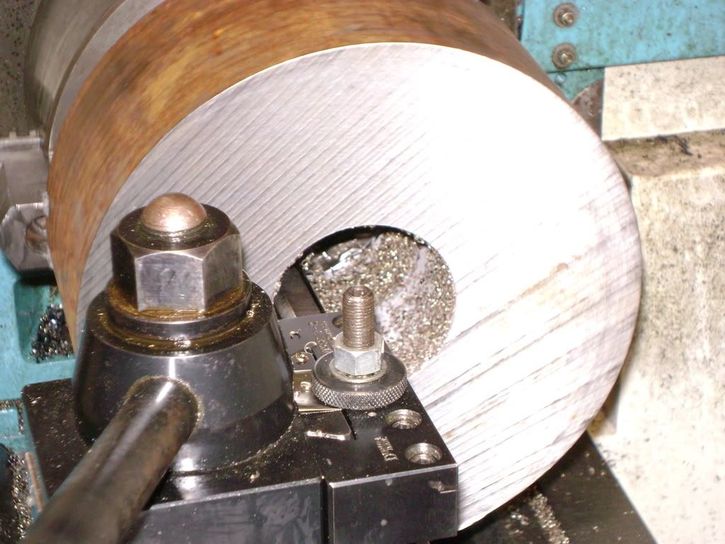

Boring the center out to fit over my lockouts.

Facing to clean up the saw cut.

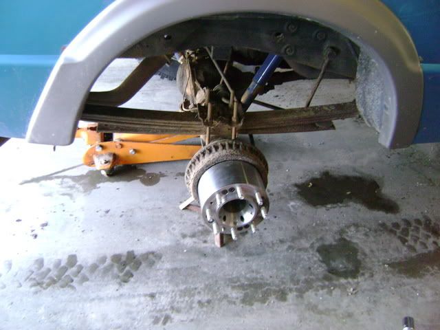

ALMOST DONE, just need to swap in the Sterling in the rear.

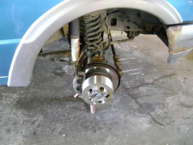

I have pics of the adaptor on the rear, I put it on just because I wanted to see how it will look, but I won't be using it, going with a Sterling 10.25 instead.

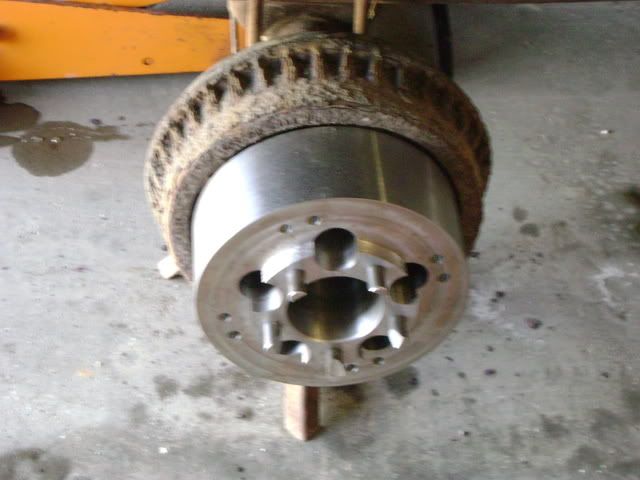

Here is the inner plate, mounted on the Front and Rear:

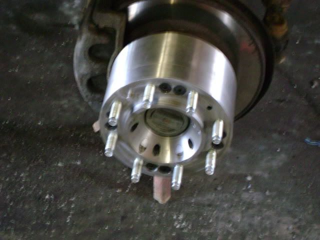

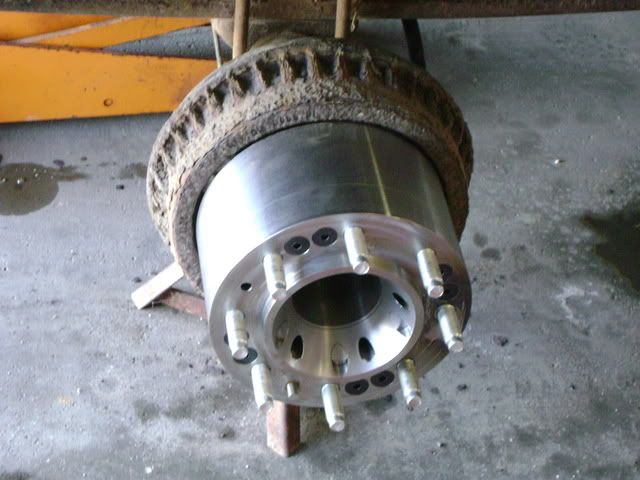

Here is the outer plate, which mounts the the inner plate:

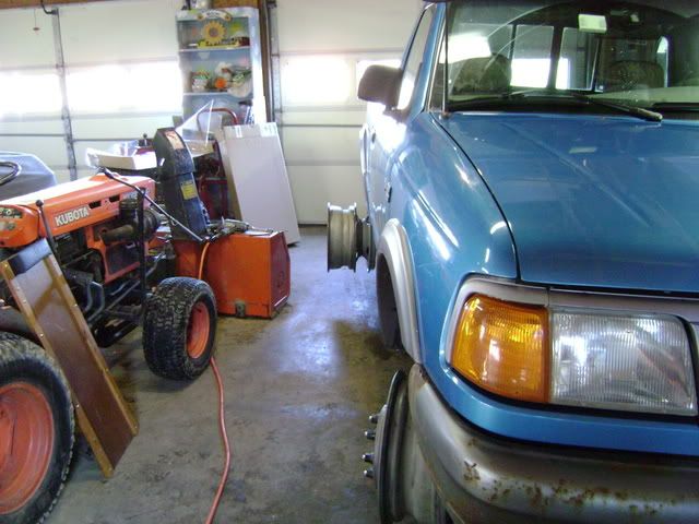

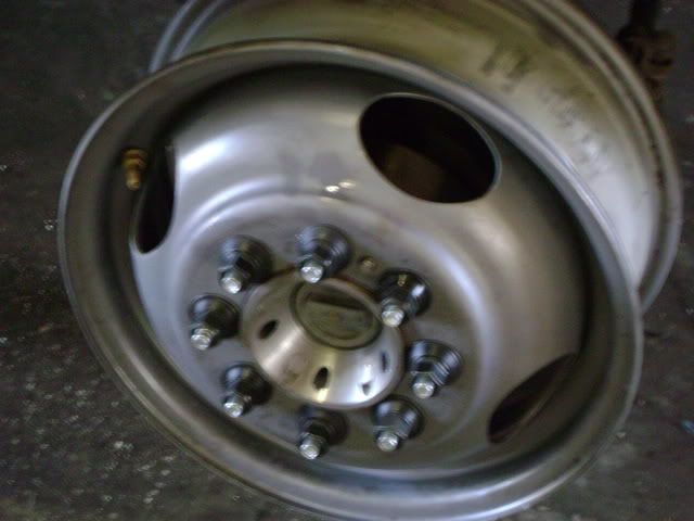

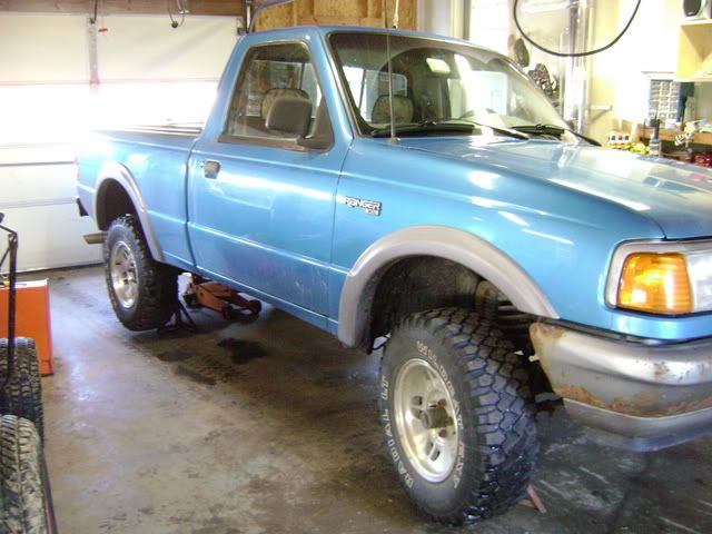

Here is the front wheel mounted:

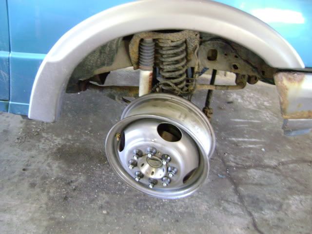

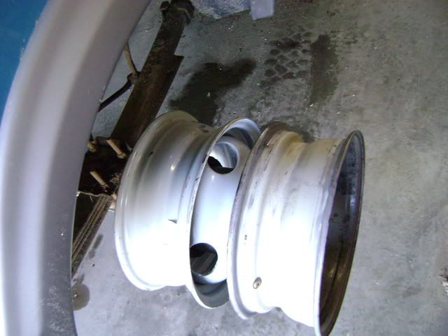

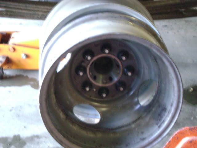

And, what you've all been waiting for:
