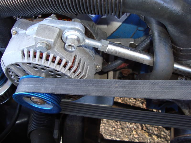

I used an alternator from a '93-ish Taurus. It was a good deal in my local classifieds, new, 130 amp, and plugged right in. My donor car had a giant 9"Alt, with external regulator, so I couldn't use that.
You could try that option.

Here's my alt. the bracket is a Fox Mustang bracket, with the tensioner cut off (Because it was missing from the bracket, and was ugly anyway...)

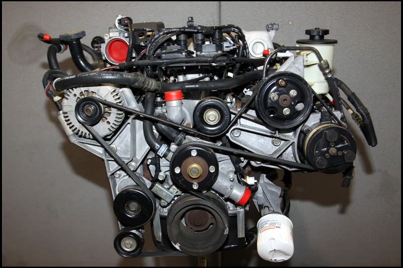

My truck no longer has AC or the smog pump. I just did not feel like making room for the ac condensor. Another option for you is using the front accessories and brackets from an Explorer 5.0. This uses the same alt as your stock Ranger, but they are much shorter than a fox Mustang(accessories closer to motor) and you can leave the rad and ac condensor in the stock location.
A 2001 Explorer for reference:

is a 5.0 explorer a/c bracket going to work with my 94 ranger compressor if so what years will work?....but from the picture it looks like the power steering pump is totally different,so then i'll need something for that.....
The ps pump on the Ex has a remote resevoir...
I guess I you'd need the pump, too.
