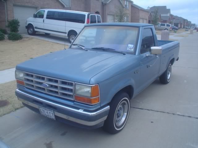

with this truck:
Towing with a Tow Bar - pix incl.
with a tow bar. i have a ball on the rear bumper of my 1989 XLT 2.9L V6 (5SPD) with no tow package. just the ball hitch.
the car is a rolling chassis.... with the bumper off... just the 2 bumper mounts.
is there anything else - besides and chain to re-inforce the tow bar needed?

I wouldn't tow jack with the stock bumper. Especially on a truck that has 21 years of rust on the tiny brackets used to hold the bumper on.
If you plan on bolting the towbar onto thos square frame horns, don't!
One, the angle would be too great for the bar, and two they are made to be smashed inwards, not pulled out on.

Use that van.
