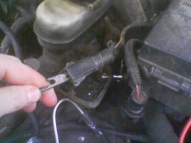

My rabs light is constantly on, i have read so many varying accounts of how to make the light flash the diagnostics code i was wondering if anyone has a definate answer, ive found this connector on the outside of power dist. box but grounding appears to do nothing. any help would be appreciated.
1997 ford ranger component location
is this the right wire, thanks

After having difficulties i used the Mitchell on Demand program(like alldata) at auto tech class and found that the connector was located behind my right kick panel. I grounded the wire which then told me there was a speed something issue. I took the bed off to do a sending unit so while i was at it i took out the differential speed sensor and cleaned it with brake clean. That appears to have solved the prroblem the light is now off.

I also have a '97 ranger with the RABS yellow light on. I have not been able to locate the test connector, only the one on the power distribution block that you took a picture of. Possibly the '97s were different than the '96 and older models. You mentioned that you found the connector under your right kick panel. Do you mean the kick panel on the passenger side of the truck? Thanks.
Yes i removed the plastic kcik panel on my passangers side inside was a conector with one wire coming in on each side, i unclipped the conector and grounded the orange.black connector, this started my light flashing, make sure that the key is in the on position.
