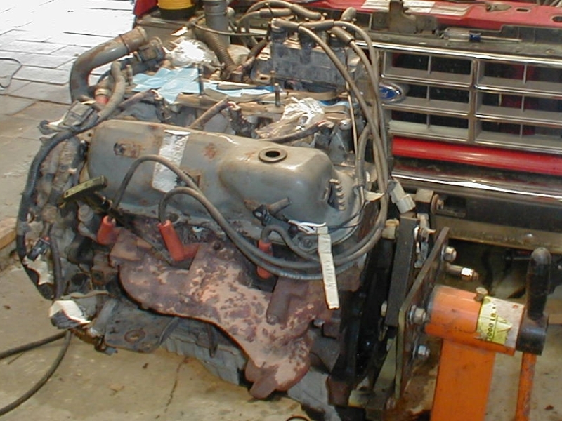

This is a 4.0 from a '91 Ranger. There's not much more to know about your engine. I'm not sure exactly what you are trying to discover. There was a kit, made by BBK that added the same supercharger you are seeing. I believe BBK claimed 220hp and 300ft#. This may be what you have, though maybe someone else made one, or it was fabbed by someone. The only other kit I know about was a centrifugal blower made by Vortech.

Well, Will, it does look fairly similar to the pictures/video's I pulled up of the BBK unit, but I see several differences. My setup has a dedicated supercharger belt drive, the BBK unit looked to be using one serpentine belt. Also, the tube that the throttle body bolts to comes around 180° on mine, and only 120° or so on the BBK. Even further, the wiring harnesses are not set up like I'd expect them to be. There are the connectors for hooking the engine harness to the main harness, but there are two connectors with about 4-5 feet of extra length to them, labeled "left" and "right" coming out of the back of where the injector harnesses are. At any rate, you are likely right that this is a completely fabbed-up unit, but one of the old paper tags(from an auction, I can only assume) on it says that the engine was, at one time at least, owned by FoMoCo in it's supercharged form. The main reason I want to know if there is anything special about this engine is I'm going to have to tune it eventually, and I need to know if there is anything special about the internals. I didn't get a PCM to work with, and I will probably end up having to change wiring harnesses. Granted, it's much easier if it's just a basic 4.0 OHV, that some race-shop put a supercharger on, but suddenly the cool factor starts dropping off if it's not a Ford experimental mule engine. Now, if I wanted a fast as all get-out Ranger, I'd be messing with one of my 460s, not a little 4.0 V6. Cool factor is kind of important here. I'm not looking for speed, I have a supercharged Fiero to take care of that. I could tear the whole engine down, measure, check, and gauge everything, but if I can get some definitive info as to what it is(appears to be just a basic 4.0), it will save me a lot of time and money.
