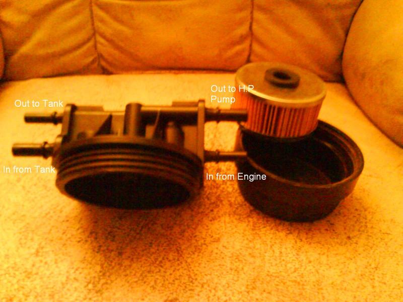

In a way, there are two filters. Inside the fuel accumilator is a wix#33268 filter. Clogged to the gills! Previous owner changed it before also. Teeth marks on it.
Blew my mind, I did not know that and never heard of it. As in, any other posts, its not even mentioned, nor in Haynes book. But one of the first filters at Advance On-Line and Napa. Guess more truck owers should be aware of this lil' nugget.

  • '87 Ranger 2.9L ~Low Fuel Pressure/Emission~

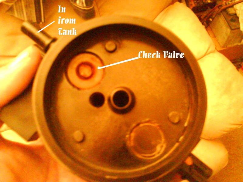

Found a new problem. The check valve for the inlet of the accummilator/reservoir is bad. Stays closed causing very little fuel to enter.
Anyone think it could be removed without signifigant stress to pump in the tank?
I am mobile! Repaired check valve in fuel accumilator/reservoir and fixed other line restrictions I didnt know about. As expected, runs like a Rat outta hell. Thanks for all the insight and recommendations. Excellent forum.

I'd also like to point out that not all of those come apart like StreetRat's. Mine isn't a true filter, its just a screener, piece of door screen in the accumulator.
Well I sure hope it comes apart. Napa had a filter listed for it, so I hope I'm not wasting my time. Thanks for the help.

That was the only filter on my truck and the donor truck I used, so not all have two filters. Both were 86's. One manufactured in December of 85 and one in April of 86.

And there are two listed for the bronco II's as well (at least on napa). But not all of them actually had two filters. Just have to actually look and verify before you start buying filters.
