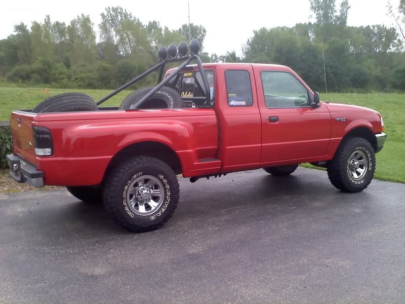

3" blocks in the rear, coil spring spacers in the front with modified 4wd shocks up front, 31" all terrains plus I dressed it up a little bit
UPDATE:
New custom made roll bar, tinted the tail lights, 32' Goodyear wrangler custom cut MTRs

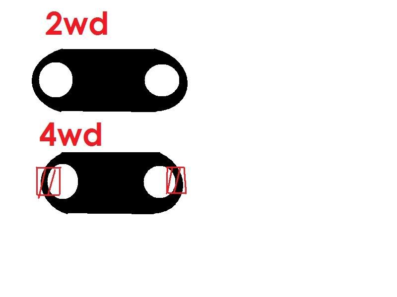

wait a second, ive been looking for bilsteins for my truck and everywhere ive looked front 4wd shocks are the same as the front 2wd shocks for every year pretty much. how did you get 3'' of lift from 1'' spacers? I have 2'' spacers and didnt even get that much lift. truck looks great by the way
Thanks and well they were not the same on my truck. The 4wd front shocks holes had to be widened to fit onto my truck.
I know your probilly like wtf? so I just made you a diagram lol. So this is looking at the bottom on the shock;
2000 2wd 3' blocks and coil spring spacers
The 2wd was a tad bit wider and so where the red boxes are we simply cut out and then installed onto my truck so that the bolts would fit.

Also heres another picture of my truck ( My parking spot at school :icon_thumby:)
