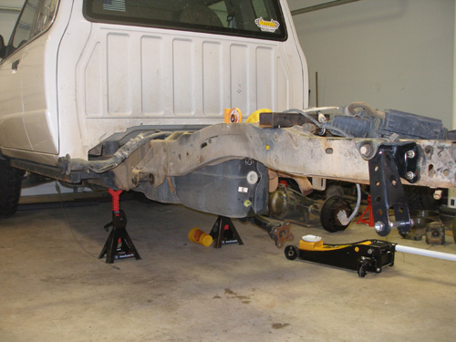

anyway i have most of parts for the rear so i decided to start there first. took out the old 7.5 and springs. ground off the rivet heads on the spring hangers and still havent been able to push them out. Dang those are in there!!
i cut out spare tire mount and 4 inches off the rear of the frame . its started slow as i can only work on it on the weekends.

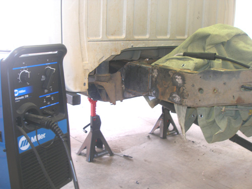

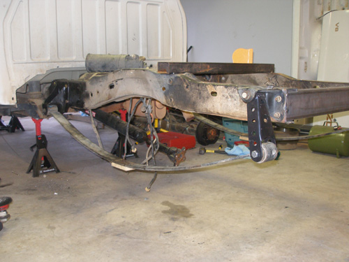

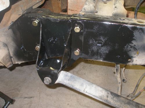

Well i finally got the rivets out. Moved the spring hanger 6 in forward. Mounted with 1/2 in grade 8 bolts with red loctite. The chevy leaf spring swap info in the tech section is a little misleading as i doesnt state for which year its being done on. 98+ rangers and B-series are different in that instead of taking away some of the frame you have to add to it, in 1/8 plate steel. No big deal just extra work.:icon_welder:
Mounted the spings to Beltech shackles. Took apart the springs to measure for bumpstops and of course the spring pads i bought are drilled out for 1/2 spring bolts and i have 5/8. I broke my last 5/8 drill bit on my bender project so i gots to go get a new one tomarrow.
So with the extra time i went ahead and made a rear bumper out of 1/4 in thick steel 2x4 rectangular tubing. My welder wont quite reach the other end of my garage so i could only get half of it done. Damn one thing after another.

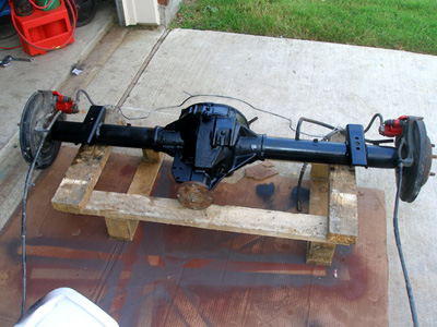

Got some more done. Welded the spring perches on to the 8.8 axle. Pinion shaft measured in at 6 degrees. Painted the axle and have to mount the brake lines to the underneath of the spring perches. I think ill just weld a bolt sticking out and and attach them. I have to order my 37 iroks next and put them on. I made the mistake of putting the truck on jackstands all the way around and with the new leaves im gonna have to jack up the truck to get the tires on. Last year i went to the Rubicon and mangled my rear drive shaft. So i had one made out of 3.5in .95 wall DOM tubing. It is much stronger than the stock aluminum one.

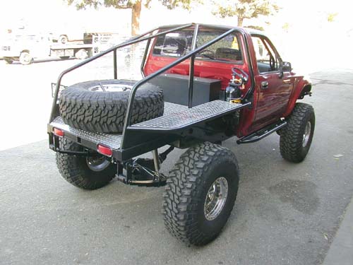

your going to try and stuff 37's under there? you might need a few more inches of lift :icon_cheers:
Naw, it will be fine. Im gonna flatbed / exo the bed. The front im gonna run fender flares.
kinda like this....

hey looks good--i did want to suggest flat washers under the rear hanger bolt heads and under the inside nuts as well.it will hold better with some good flat washers down there.
and good job on using metal like the thickness of the frame--i see a lot of people adding in thicker to weld to thinner and it always seems to crack at the joint sooner or later.

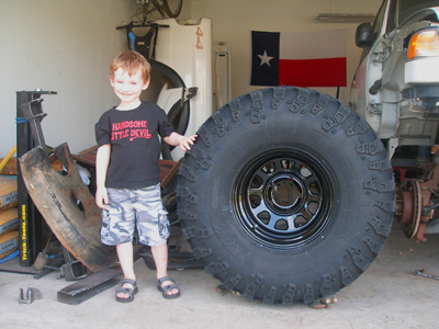

Picked up my tires and rims today... 37x14.00x15 iroks on 15x10 black steel wheels. My son is stoked on HIS new rockcrawler tires. Bias ply, if anyones wondering most balance weight on one of the tires is 9 oz. I give it 2 miles before they fly off. Hope to get them on the axle and under the truck tomarrow. Not sure if the top of my truck will clear the garage door opener!

im suprised those biased ply tires only took 9 oz. if/when they do fling the weights, i doubt you'll notice a difference since bias ply tires deform at highway speeds anyway.
yeah, I think thats all they could stak on top of each other.

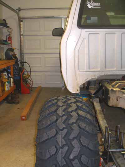

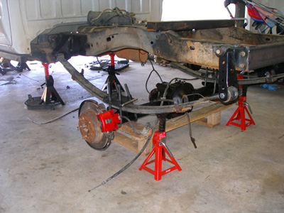

Got the axle under the truck. Have to install gas tank and drive shaft. Next week cuttin out the IFS. Here's a couple of pics.

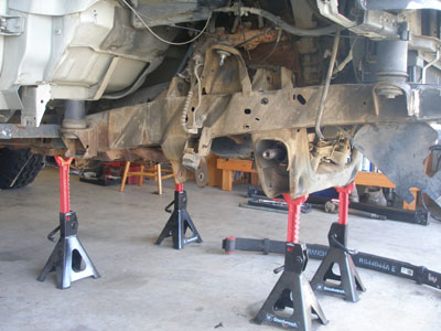

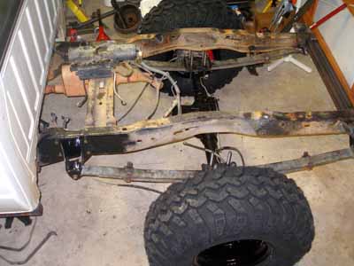

got all the IFS jive out. I ran out of gas for my torch , so gonna cut out all the brackets and get my spring hanger mounted next weekend.

Nice progress so far! You will be very pleased with the Chevy 63"/Belltech shackle combo. I have been running the same set up on my truck for several years now with good success.
As for the front I would go with an ARB. They are more costly, but I believe they're better than the OX locker. I've seen the OX locker not engage properly on occasion.
I would also suggest looking into the Superior Super 88 kit. It would be just the ticket for your axle and is much less $$ than a full floater kit.
