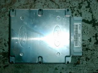

92 2wd ranger cpu

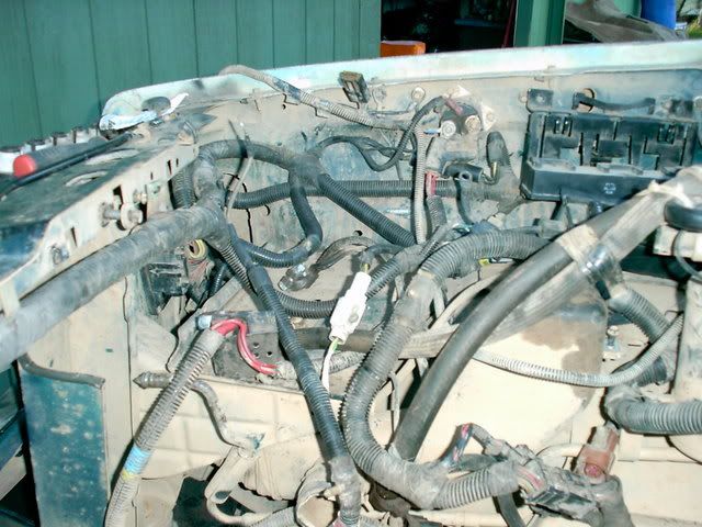

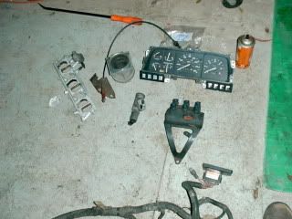

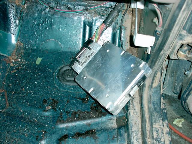

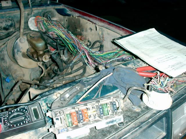

so i tore into it today finally and removed the 2.9l cpu,
engine bay harnesses and got the donor cpu,its harness,and the drivers side harness into my truck.

i figured it would be easiest to re-pin the 92 donor headlight harness to match my 91 dash harness,

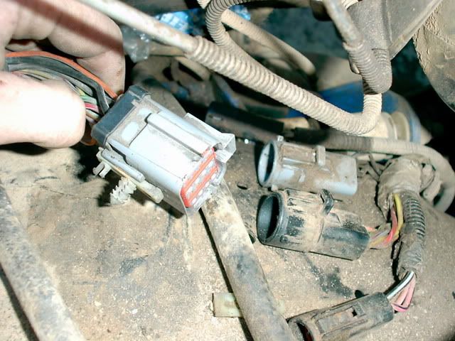

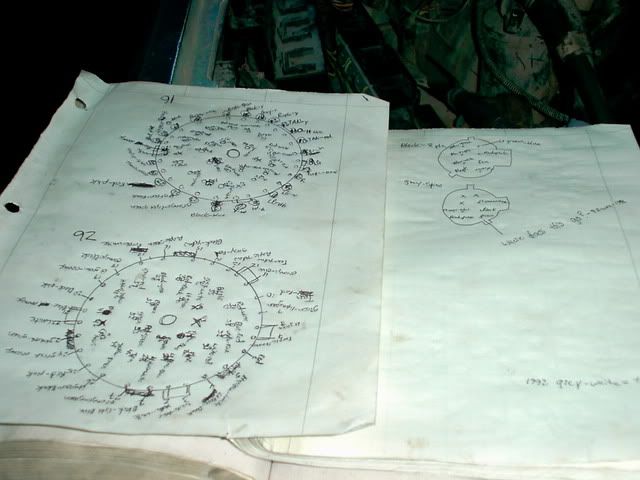

so since i don't have a diagram yet of the big connector i unplugged the 91 harness and cut off the white connector with a cut-off wheel about 1" from the connector so it would be easier to draw a diagram with the body of the connector and where the pins are in each connector-(91 and 92),and what color each wire is.this is made easier by the terminals on the connector being numbered 1-53.i noted 8 wires that were different and am still working on them.
92 4.0l into 91 2.9l truck?
this plug in my hand and the two to the right had me worried but ford left the wires the same color and i was even able to just take the wires out of the big connector and slide them into the ends i cut of the 91 harness.

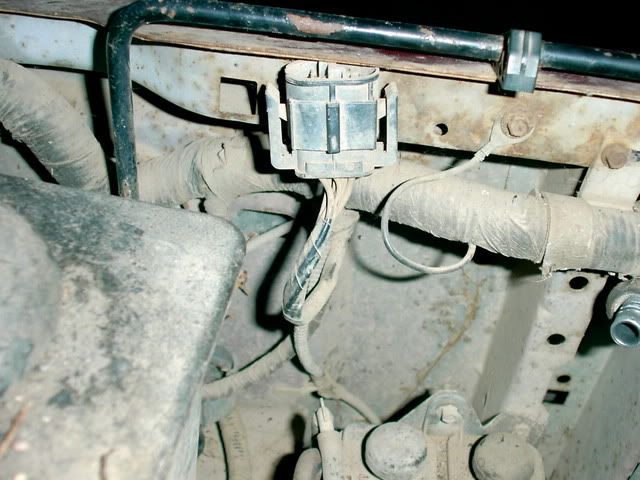

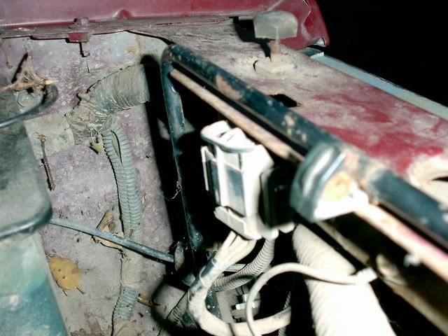

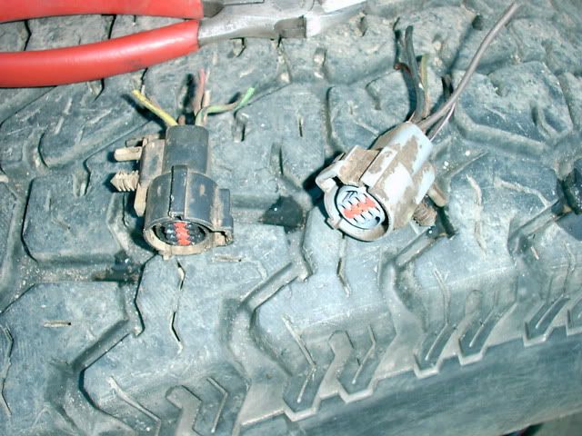

so i'm down to 4 wires left!one of them goes to this connector/plug?:
do any of you guys know what it is?its on the drivers side,inside of the radiator support,it has a plug in the end with 4 terminals inside.in the circuit i'm chasing,both harnesses(91 and 92) go to this in the same terminal but the wires are different colors.:dunno:
