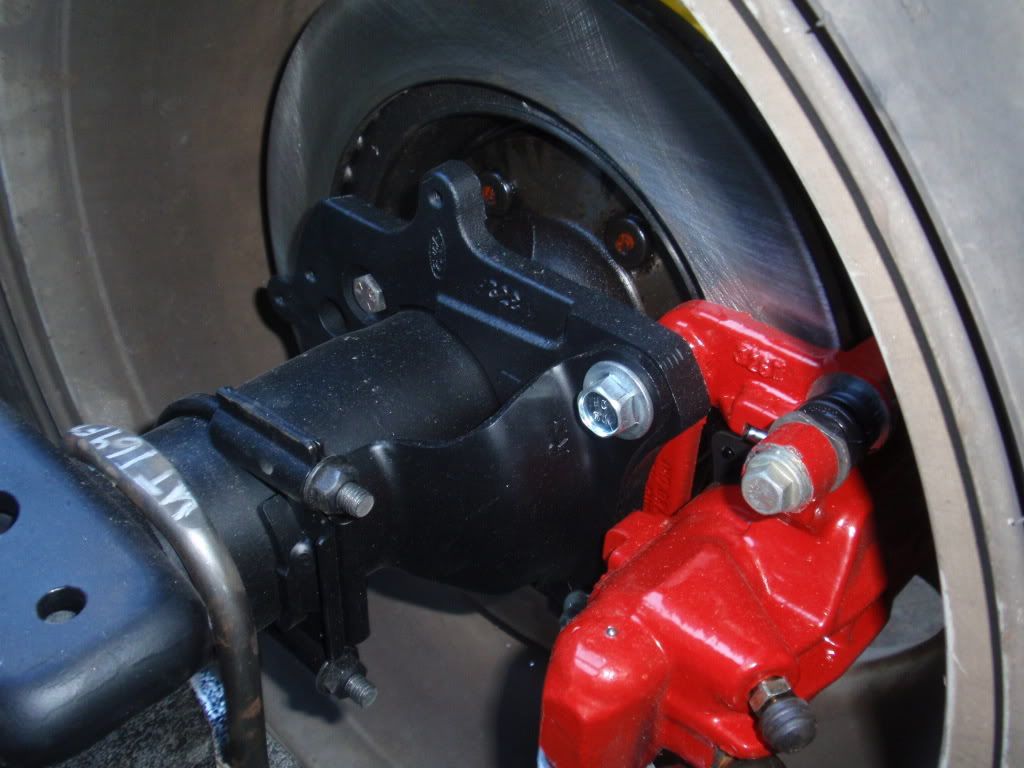

Mustang brakes ARE a bolt-on. Does require cutting the stang caliper bracket, but thats nothing compared to getting someone to weld perches and shock mounts and you still have a parking brake that's a pain in the butt to work on(explorer)...
Stang brakes you can utilize your EXISTING p-brake line that you disconnected at the drum.
My brother's Stang brake info page:

Some pics pulled form his page...
http://www.ranger-forums.com/forum2/f6/f43/f59/95557-how-rear-disc-brake-conversion-stock.html

Wow, that is a lot of material removed from that bracket and part of that material removed is a mounting hole!!! I would be concerned about its integrity and safety in a situation where you need to slam on the brakes.
If it were my truck and I absolutely had to have rear discs, I would find someone to weld the brackets on an explorer rear end and go from there.
I also understand that a vented drum from an Aerostar will fit on the 8.8... this will give you better cooling on the drum.
AJ
^^^ Shane wouldn't let his brother cut a bracket like that and put it on his truck if it wasn't safe. If you don't want to cut the bracket like that find an explorer axle with disc brakes and swap the whole axle in.
It's perfectly safe and havn't you ever noticed how front caliper brackets are only mounted via 2 bolts? 3 grade 8 3/8" bolts are just fine.
