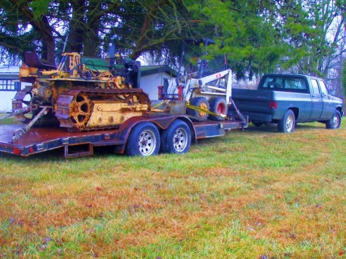

Type 6.2 diesel on EBay and then type Cummins and you'll see why a 6.2/6.5 makes more sense. You can scrape together a GM diesel Ranger for almost nothing. All you are pushing with it is a 4,000# Ranger. I can assure you that with a turbo you won't be disappointed. I use mine pretty regularly to haul around some combination of my junk and it's no slacker. This is a 10,000# trailer. Pulls about 7psi and 700F while accelerating in normal traffic with that load--about 16,000# gross. I've had this at 80mph before following a line of cars around a truck. I'm sure I could pull it 90+ if I wanted. I don't worry about at all--just watch the exaust temp. This motor is everything you want out of a diesel and a good diesel for a Ranger--unless you want an 80hp aluminum diesel with a timing belt.
