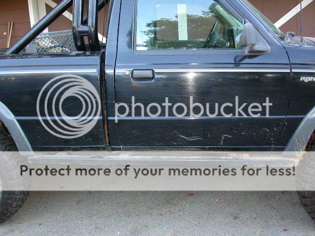

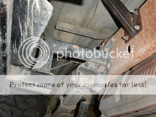

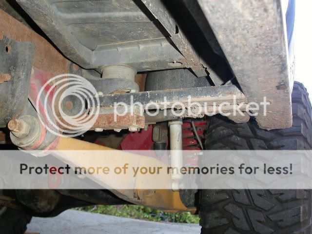

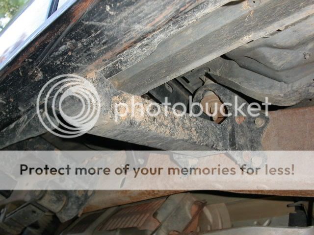

I'll have to find the spec sheet but here's some pics
The initial bolt-on
Strong enough to jack up the truck with
Finished product
