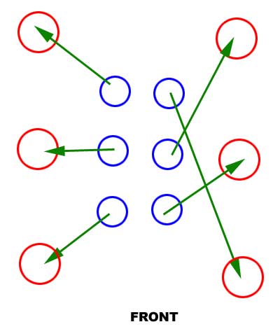

I was farting around in the "Tech" section and found this for fire order...(on the left)
what I have in my Chilton is this....(on the right)
which is correct for a "93....this may explain the real rough idle I now have.

After I posted this I looked at the pictures....they are the same! I went to my chilton and got a print out that I got off of "the other site" and it was wrong!:bawling: Don't know why it would give a MAF code with #5 and #6 wires swapped, but it did.....just drove it around the block and it ran great:headbang: I'll take it to work and see how it does on the highway...thanks to all who read this and gave or will give input....Nate
