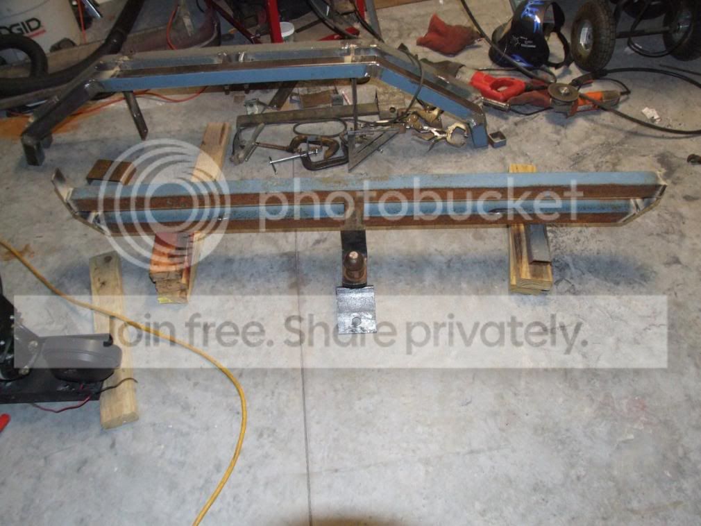

fabbing up the new bumpers...
Rabbit's '88 B2
Rabbit's '88 B2
Rabbit's '88 B2
Rabbit's '88 B2
Rabbit's '88 B2
Rabbit's '88 B2
Rabbit's '88 B2

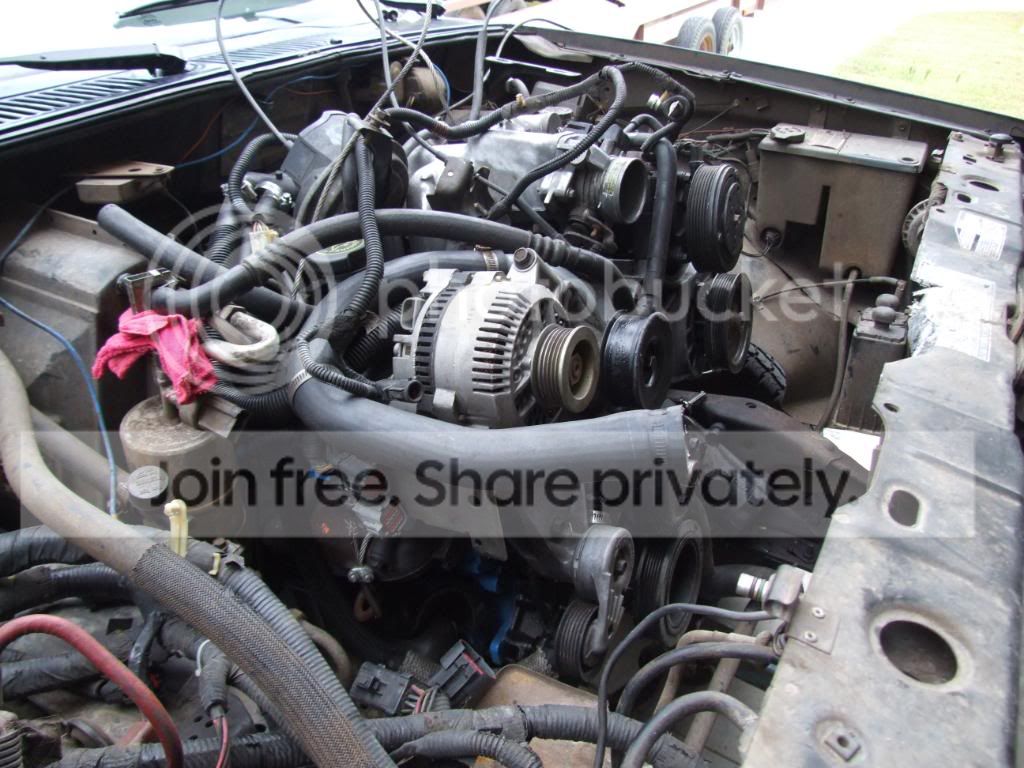

Pulled out the 2.9...
Rabbit's '88 B2
...and put in the 4.0...
Rabbit's '88 B2
