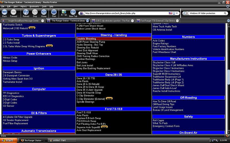

I don't get it...if the internal spring was such a bad idea, why is there a huge write up on it in the tech section. I guess I will look into the external spring, thanks
Did you miss the huge link that was right under the link you clicked on that said "NEW" in big rotating letters and had "external" in parenthesis?

  • D35 C clip elminator question
