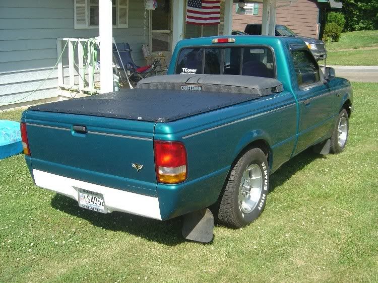

OK, I'll play. This is the low-buck edition. If you're looking for something radical, keep moving. :)
Photos of different wheel/tire sizes on stock and lowered 2WD's
Drop: 2-1/2" rear w/ hanger flip, 2" front with Western Chassis coils
Wheels: '07 Mustang 16" X 7" Base Model
Tires: stock Mustang 215/65X16 BFG's - I plan on a set of 225/65X16 General Altimax HP's when the BFG's are done as the OD of these is nearly identical to the stock 225/70X15's.
Offset: 37 mm
Spacers: 1-1/4" cheapos rear, 1" Eibach front

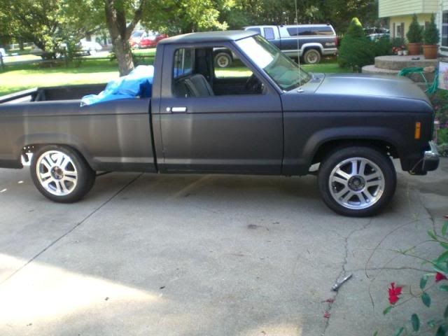

17x8 stock mustang rims

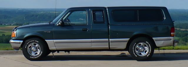

Stock suspension with Ranger Splash 15x7 rims.
Tires are BFG A/T 30x9.5's.
Slight rub on fender liner when flexing the truck (like on my 30 degree angle driveway:annoyed:).
