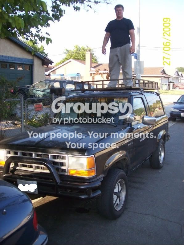

Me and my brother in law are building one for my 90 B2. We built one for his Suburban, and going to work on mine this weekend or next. His is a 10'x4', and mine's going to be a 6'x4'. We used 1" square tubing, with the bottom bars 6 inches apart, and a 6" basket. Then we did a few coats of black Rustoleum, and he mounted it where his old roof rack was.
For mine, we took some gutter mounts off of an old painter's van at Pick-a-part, and will weld the rack to there. You might be able to find smaller ones off of other vehicles too.

Finished.
My brother in law stood on 2 of the bottom bars, with little bending.
We noticed that the front and back gutters are not straight with each other, the rear ones curve a bit, so the brackets had to be mounted a little crooked.
