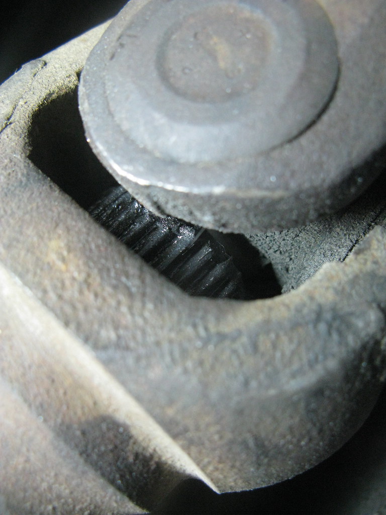

Here is a shot of the axle poking through the slip yoke bottoming out on the U-joint
This is with the beams almost flat straight even. This allows the small gap in the picture.
As it droops they bind and it does not drop out. This *is* the shorter shaft from an F250.
