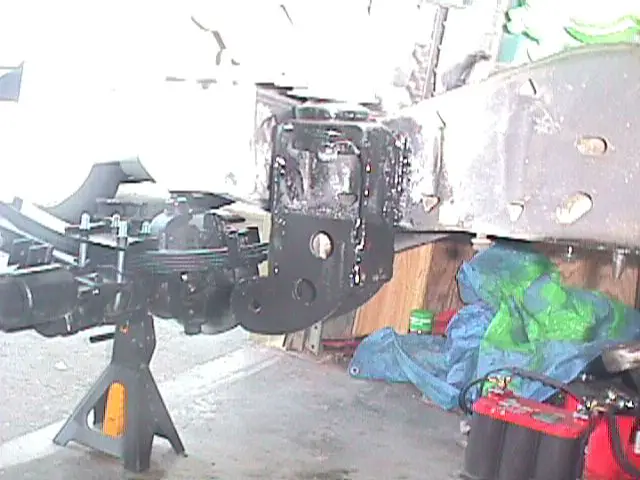

I put a HP D44 from a bronco in the front of my 00. I tried two different routes for mounting the springs.
Under the chassis brings the leafs further in, giving room for tight ass turning, and great flex because there's more leverage on the spring, and it has to flex less at the spring, but looks like more at the tire.
My rear hangers are just welded near the tranny x member.
My front at first was two hangers welded straight to the chassis and some bracing in between and along the rest of the chassis. It was pretty stout.
My CURRENT set up is a piece of 3x6 square tube with .250" wall. I knotched it so that it snugs up in the chassis about 3". The front hangers are welded and gussetted to that. It's stout, easy, cheap, and easy, and cheap.

Here's a pic:
Best way to run leaf springs, SAS?
I'll tell ya now, this spring set up is soft as hell. This picture is with two buds standing on my step.
