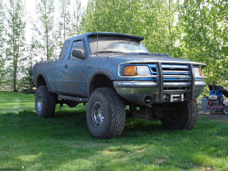

First off here's my concerns... Those welds (first of all) and second that will not hold under much of a pull unless I am seeing this incorrectly.
Am I right that you welded that winch plate to the front bumper and the stock bumper brackets are holding everything on?
Here's the pics I have for you...
This one is the first winch i had mounted, ( a MM9000) with a hawes fairlead.
and here's one with the winch and bumper removed so you can see the tubing it is setting on.
what I did to mine was cut off the ends of the frame where the bumper mount to, weld in a piece of 2" x 8"(IIRC) x 3/8" wall rectangular tubing between the frame rails. This is what the winch is mounted to. Then I welded the bumper lift brackets to the outside of the frame. Next took off the bumper brackets from the actual bumper flipped them from side to side and weldign them on.
This way the only thing supported by the bumper brackets is the bumper. The winch pulls directally from both frame rails.
You have a good idea but IMO it is not anywhere strong enough.
Chris

X2. I would be scared to use that.
Mine is done quite similar to 97_4x4's. I used a piece of 1" thick by about 8" wide plate steel. It bolts directly under the frame. I have a body lift so that's why the winch is so much lower on the bumper. I knew it would be a hell of a mess to try to do it without. I don't have any pics of the process, but it ended up like this:
