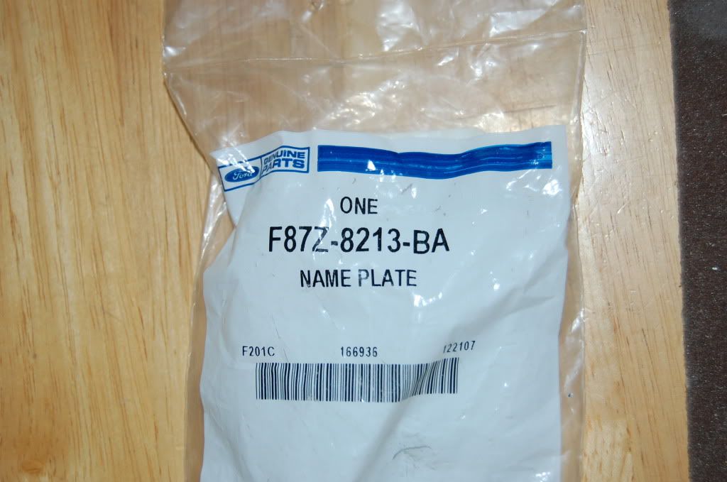

Part Number of the Emblem you need
How To: Ford Oval Color Change

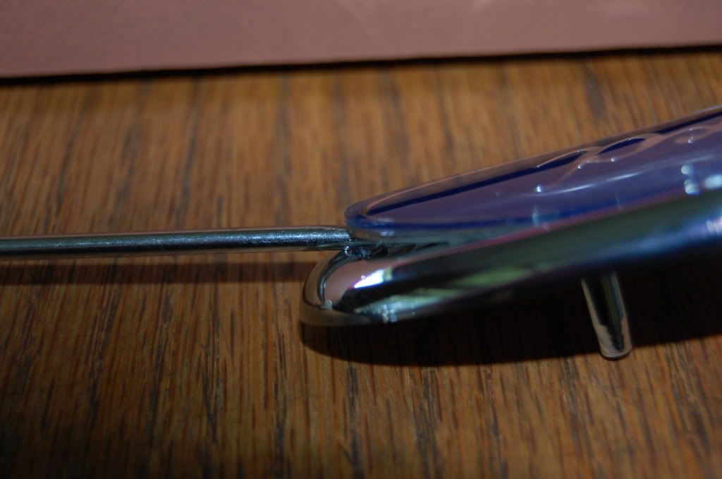

Next be careful not to burn yourself on the emblem it will be hot. Now comes the fun part separating the two pices. Grab your little screwdriver and start to pry up on one side. I found that if you work your way into the little grove it separates very easily.

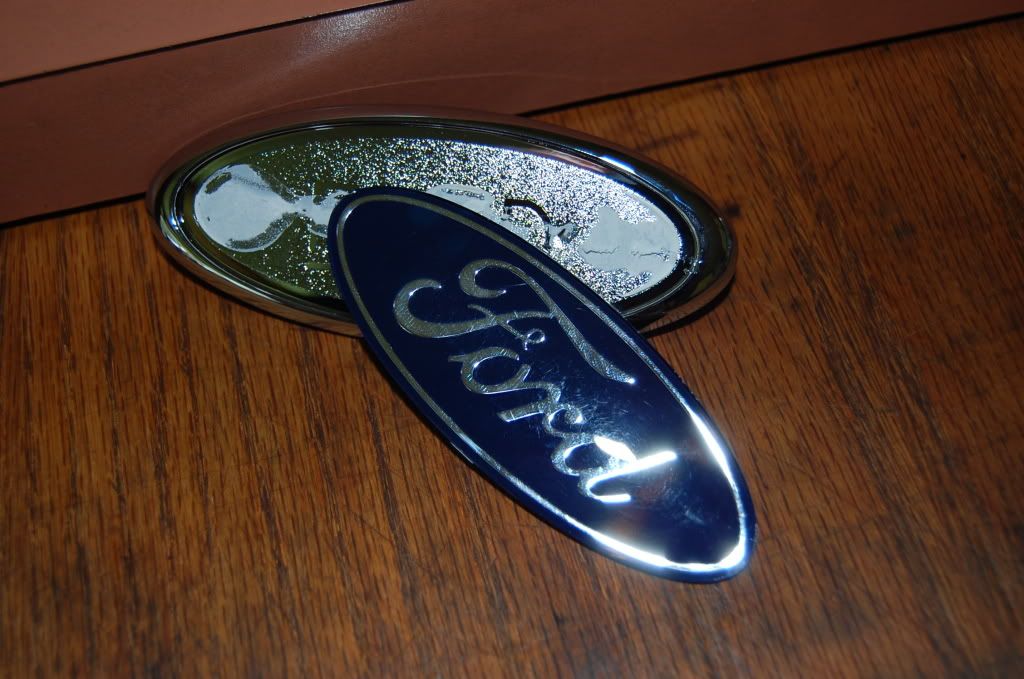

When you get to this point STOP!! Re-heat the emblem and work the screwdriver around the emblem to separate the pieces. If heated correctly it should come apart like this.

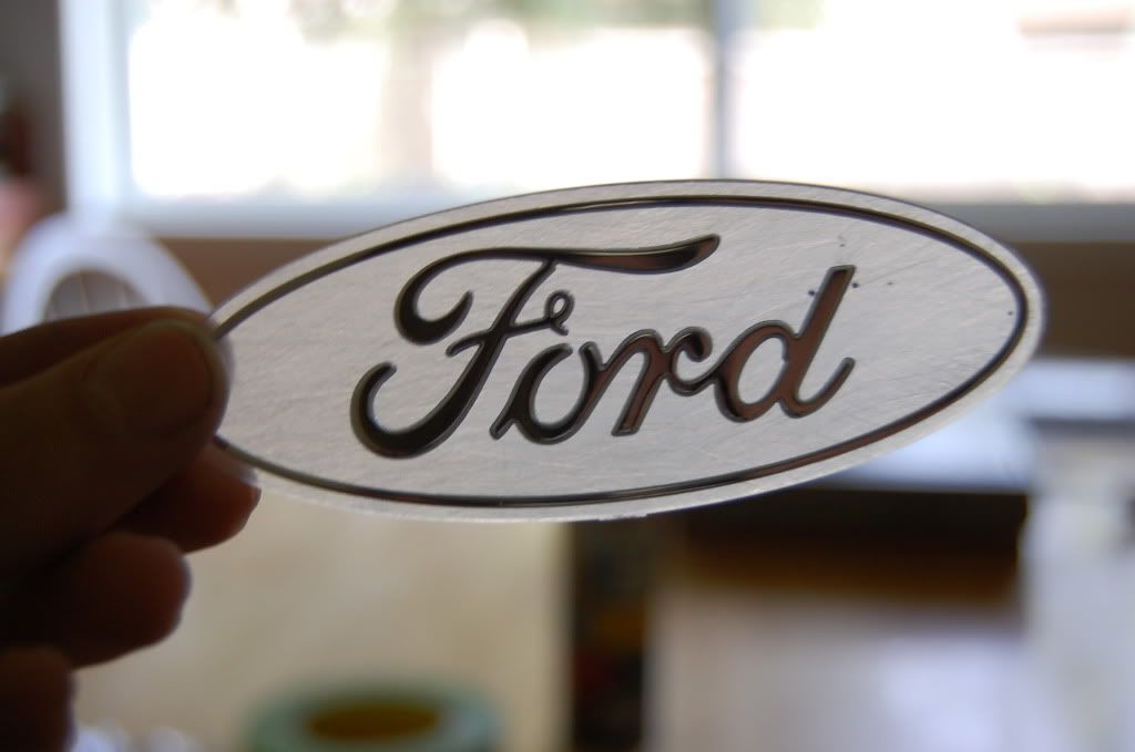

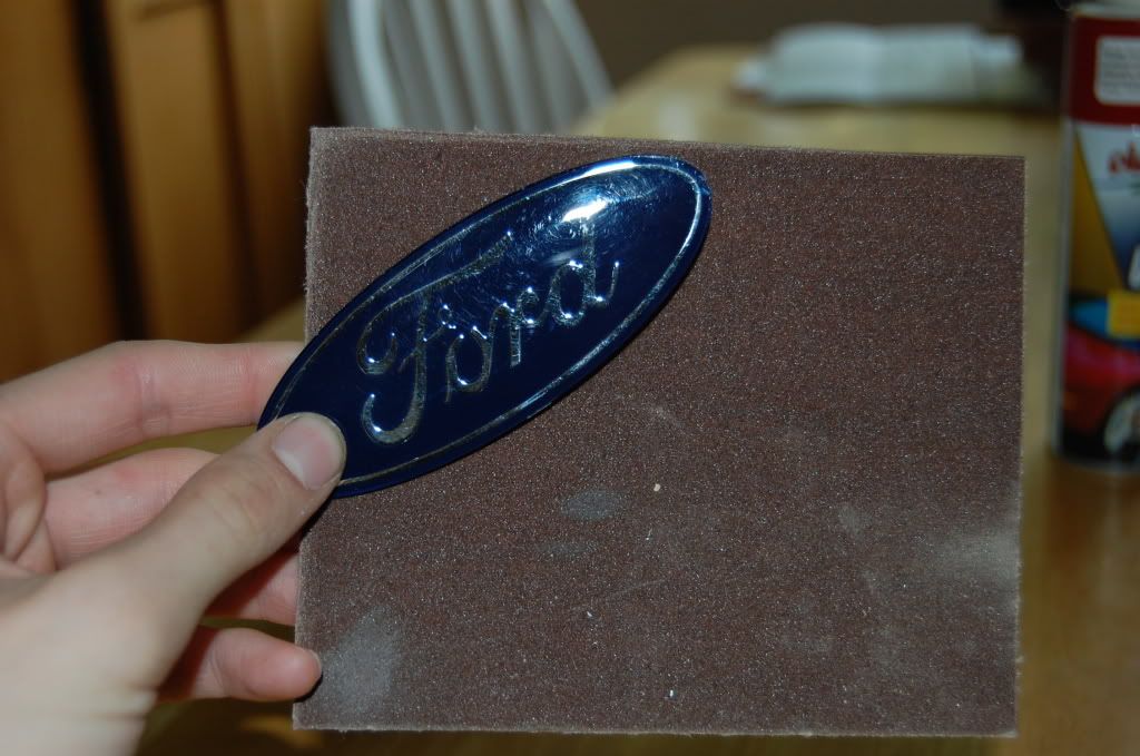

Now your ready to start sanding the Blue paint off. Don’t worry about the lettering because it is set into the emblem.
Once you get all of the blue paint off it will look a little milky, don’t worry when you paint it it will not show.

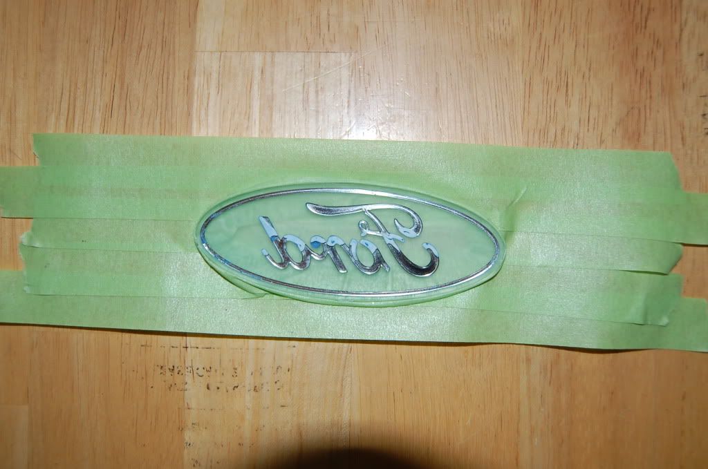

Now you can tape off the front side of the emblem and start the paint process.

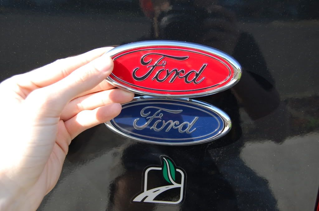

Here is a comparison of original on the bottom and modded on top.

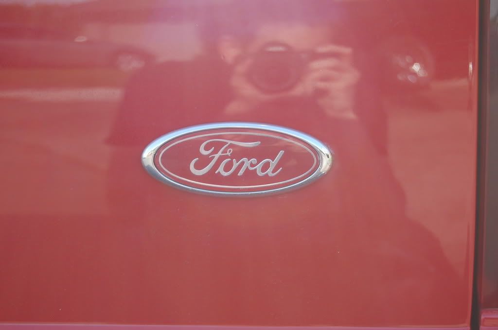

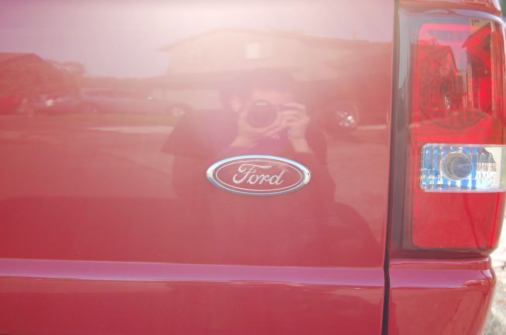

What it looks like installed on the truck.

That's actually pretty cool. I might try this one day. I see the pic with the bag with the part # on it - how do you go about obtaining this? I wouldn't want to try it with the emblem that's already on the truck. And has anyone done anything to the fender emblems?
I got the emblem from Ford, any older Ranger emblem should work
