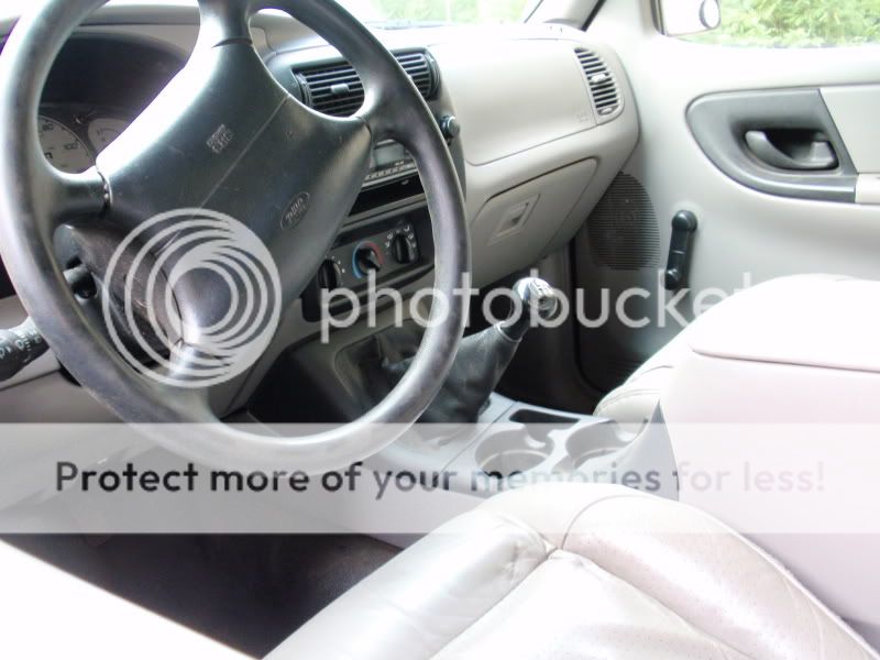

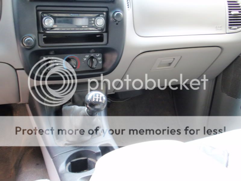

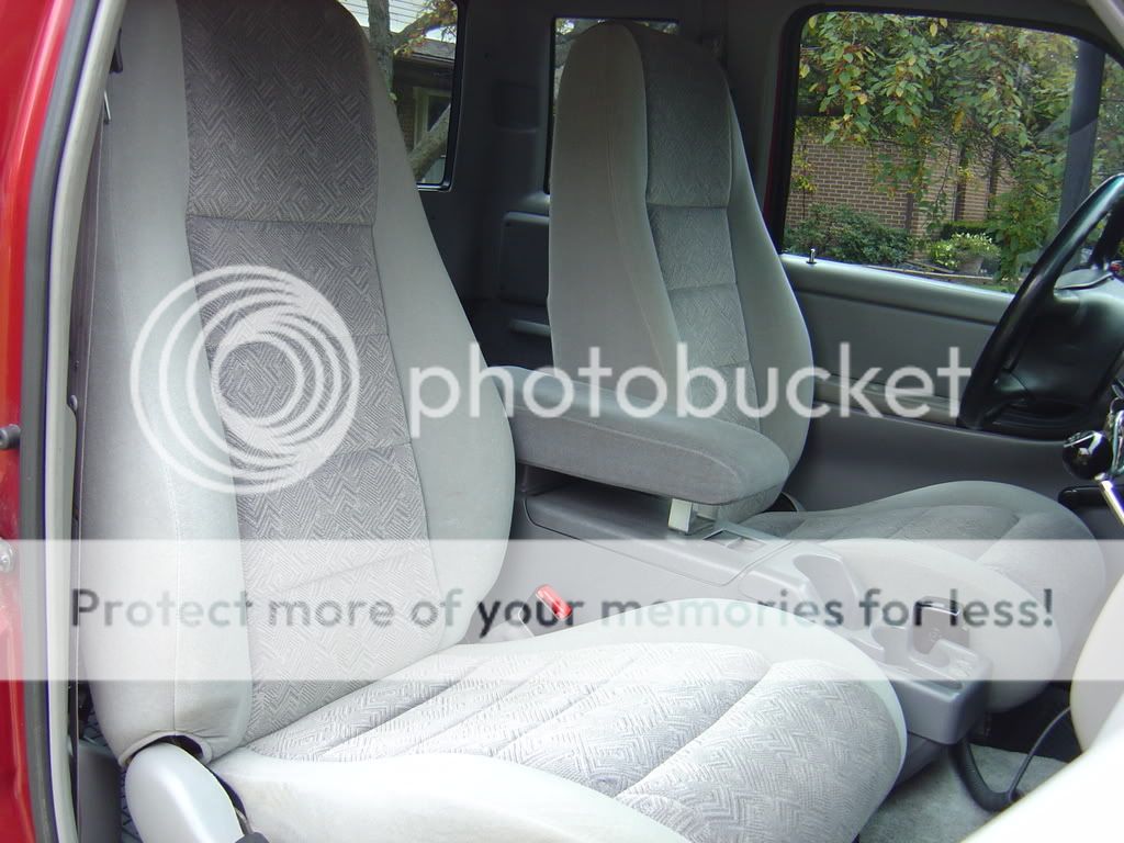

I have had both style consoles I posted pictures to below. I personally like the shorty console a lot better than the full length.
Here is some pictures I pulled off the web.
Shorty Console:
Full Length Console:
that center console is pretty sweet in the 2nd pic..

Now does anyone know if the larger console in the second and thrid pictures will fit in a regular cab ranger?
yea it should fit perfect..
you have to do some trimming on the back of it to get it to fit.also your going to lose the rear cup holders.
haha...Maruice posted the pics i was gonna post. shoot....ripped from my pbucket! lol.
Expo console posted above is my buddy's old truck, TrePaul86.
