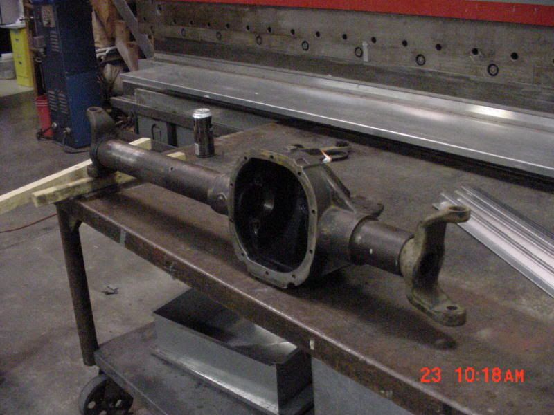

I removed the knuckles and proceded to cut the inner C's off the housing.

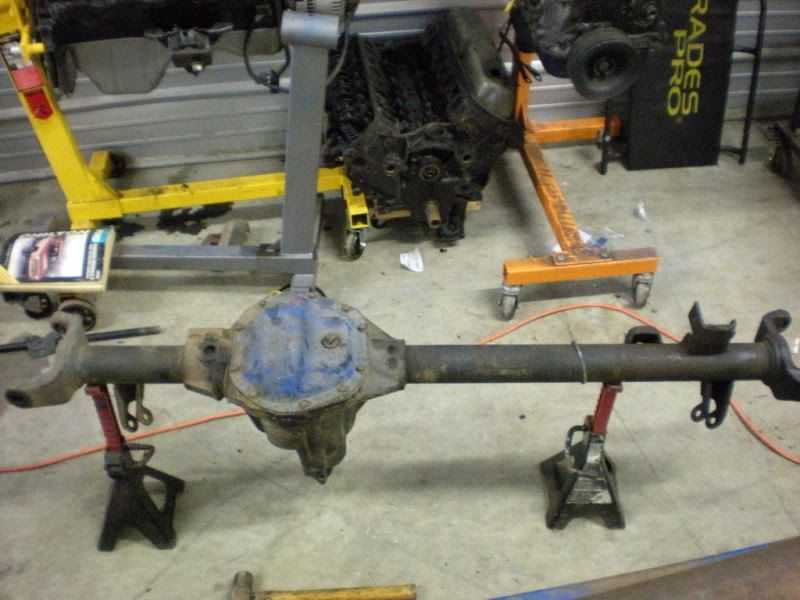

I also picked up a full size 8.8 from a 92 bronco that has a Trac-lok for $75. Ill put my 4.10's I have on the shelf in and rebuild the trac-lok with the disc/fiber/disc/fiber method.
Im using a fullsize axle because because it gives me a little bit more tubing to play with to get the width I want right..

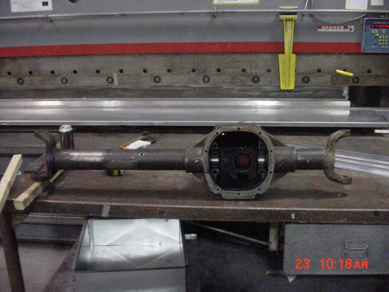

Shaved all the brackets off of the housing. Its basically bare now aside from the bearing races and those are going to stay in there.
8.8/D44 Hybrid Build Thread...w/PIC's
Still needs a "brakleenup" and a wire wheel job and that will be next before I start the work on it.
Im hoping the tube thickness is .25", because if it is, my D44 inner C's will fit right inside the tube and it will save a little work, I wont have to lathe up any adapters, or machine the old axle tubes off of the C's.

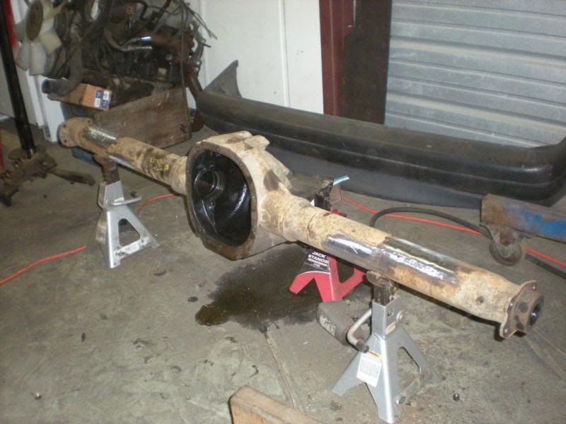

Got the length cut today, the C's are just sitting in there for show right now.
