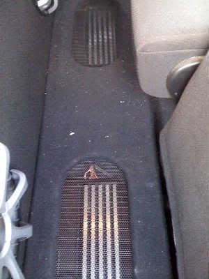

looks awesome, links to your amps and woofers?
i thought you had some filler speakers under there at first.. how did you manage to do that with the amps though?
-edit
oh did you make a box for the amps, then put the box on the floor?
probably pretty secure... if you bolted the box to the floor and bolted the amps to the box.
you should have made this a project including photos, would have been a really nice project. nice set up though, looks like it works great if you have an extended cab and don't need it.
subs 2 12 kicker cvt with 09 grills,
amps, alpine m650, and alpine f600
i ran the wires, and built the deck you can see in pic 2 to even the floor out, Velcro ed the amps to the floor, then built the, amp rack and attached it to the deck, then built the box,
the deck is bolted to the floor the box is bolted to the deck and back wall, and the amp rack is just screwed to the deck,
everything is 3/4 mdf with lots of braces, so i can put anything back there, i want to and not worry, all ready had some one sit back there, tools, saws, gun cases car parts, just not wet stuff, i like it, and it does the job.

od dimensions, for the box 49 inches across 6inch at the top 10 at the bottom 16 high
how come you angled it?
just for more volume?
less actually, min sealed vol is 1CF x2 is 2 CF the box give me 2.6CF minus some for the center brace in the center, but its also tilted back some so i can lay the seat back that much more, and it so there not aiming right into the back of my seats not that it matters much you can hear it a block away.
