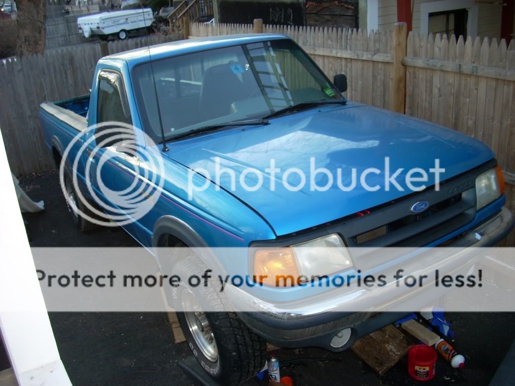

I picked this baby up for $600 bucks....the guy wanted $900 but given the amount of work it needed i just couldn't give him that.
The goods:
-body is solid, minimal bed rust
-aftermarket bed liner
-118k is low mileage for that year
-heads and head gasket were replaced a few years ago
-frame is solid
The bads:
-broken rear slider window
-chipped front windshield

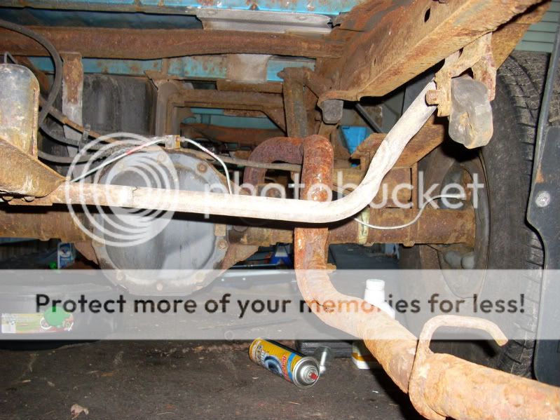

-shackles and shackle mounts are toast (one is completely gone)
-clutch problem (i determined this to be a bad slave cylinder)
-shocks are toast

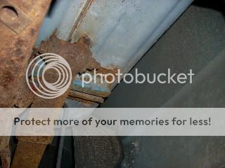

-lots of surface rust on frame and everything that bolts to it
- ball joints feel loose...maybe wheel bearings
The mission:
This is replacing my trusty BII. Make this an inspectable DD for home depot runs, homeowner hauling, etc., that will last me a long time (given the mileage is so low). Also put 2" of lift in it and 31" tires for some moderate off roading.

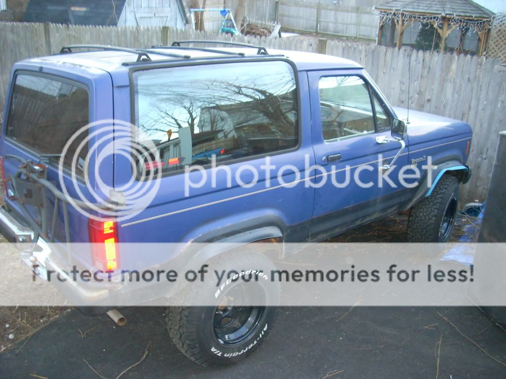

Here is the trusty BII. 1988 eddie bauer, automatic, 174k. This thing has countless hours put into it just to make it inspectable and drivable. The wife is making me sell it because i cant have 2 trucks :(. Its not a looker but its functional and does fairly well on the trails.
Parts im stealing off it:
10" rims and 31" BFG A/T's
2" superlift leveling coil springs, (unless i can get enough money for the truck with the coils in, then i can use the extra money to just buy another set @$200)
Here are some of the problems

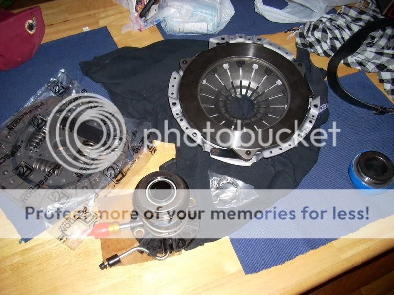

Mission 1: Replace slave cylinder and put in a new clutch and rear main seal while I'm at it.
This proved to be a WICKED tough job, due to the Y-pipe refusing to come off the manifolds.
2 weekends later, tranny is out, had to sawzall the y-pipe.....:bawling:
Here she is. Cleaned out all the brake fluid in the bell housing, siliconed the shift rail plugs.
Here is the transfer. I broke 2 bolts in this bad boy, i had to drill and retap them.....NOT FUN.

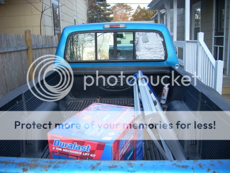

$200 for slave, clutch kit at advance auto parts

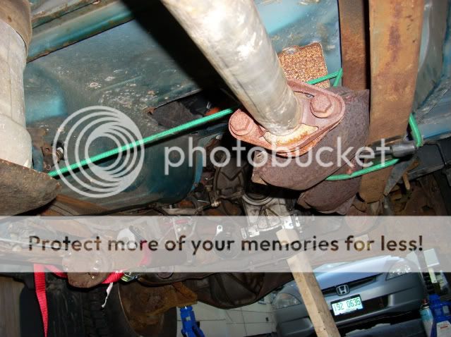

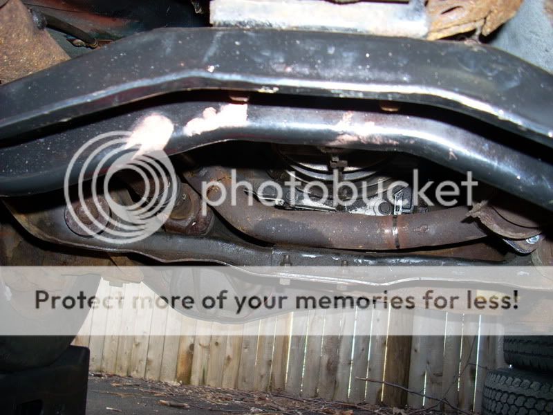

Everything back together. Got the old y-pipe rewelded at work. Note the 2 cut locations. As expected, it didnt fit very well with the width of 2 sawzall blades missing from it. I was unable to bolt the braket on the cat to the tranny mount. We will see what joys this brings for me down the road. I would suggest if you ever remove the y-pipe this way to tack it first, fit it up, then weld it solid.
With the tranny out it was possible (BARELY) to drill out the manifolds and replace with bolts. Unfortunately i did not use stainless........i may be replacing those soon.

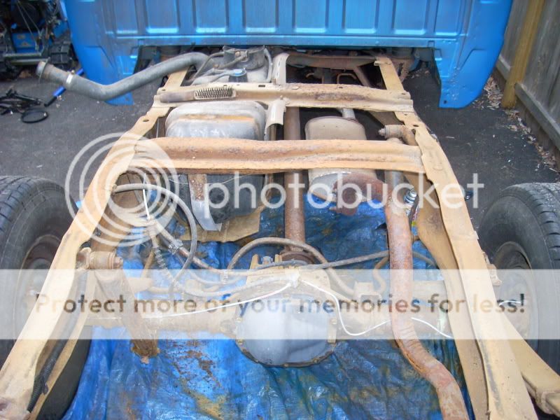

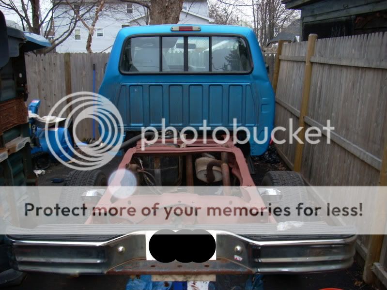

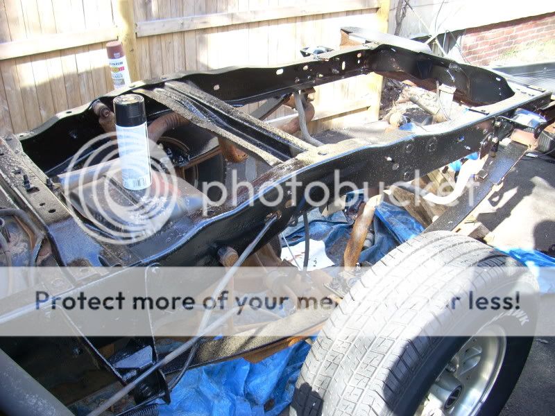

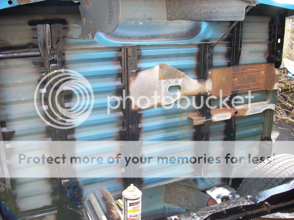

Pulled the bed to do shackles and paint the frame. While the tranny was pulled i did some brushing and painting under the cab. Rustoleum primer and gloss black is my choice.....its nothing fancy but it will slow the rust rampage right?
Here it is after some angle grinder wire brushing and hand brushing
Primed and new shackle hangers on. Slider window from the junkyard, $50. Waiting for 2" lifting shackles
Gloss black. We will see just how tough Rustoleum is over the next few years....

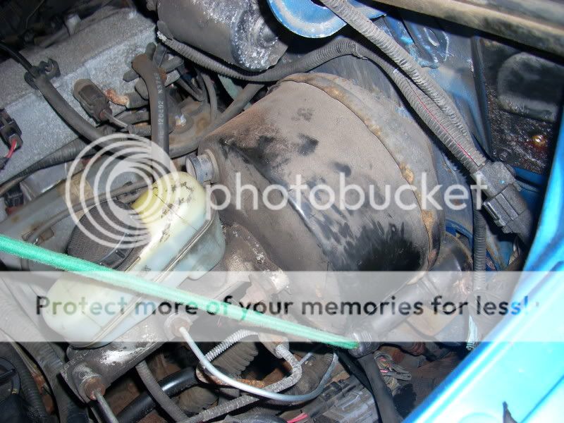

Still waiting for shackles, so i decided to attempt the bleed again with the master cylinder tilted in the firewall and a tube running from the slave bleeder to the reservoir.
Here is the master unbolted from the firewall and held somewhat horizontal with a strap. I also have it on ramps so it is actually barely higher on the inlet/outlet end...which is good.
Here is the line pushed onto the bleeder. 2.99 at home depot, 1/4" ID
Here is the line running to the reservoir, on the outside of the truck so i can see the air bubbles coming up while pumping.
Because the pedal is disconnected, a screwdriver through the eyelet of the master push rod worked well to pump it.
All this is great, and i saw alot of air coming up, and had to top off a few times. After a while it was solid fluid. At that point i disconnected the line from the bleeder and closed it. Put everything back together and.........................
Still grinds going into reverse!! LOL. It is still barely brushing the clutch. At this point i am stumped....probably just gonna drive it and see what happens over time. I cannot figure this out. The only other thing i can think is the master is junk, but i do not see any fluid inside the cab and the check valve seems to be working because the fluid reservoir doesn't budge when i pump it. I realize this question has been asked a million times but is there anything i did wrong here?
