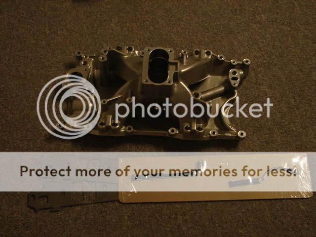

My MegeSquirt stuff got here so I spent a couple hours after work assembling the board (I do a lot of circuit board building and repair at work so it went pretty fast). I also bought an M1 Intake manifold, the stocker falls on it's face after 4500 RPMs and this also elimintates the leaking belly pan on the stocker (which mine has, not surprisingly).

I plan on installing the M1 intake manifold.
The factory "Kegger" manifold
The Mopar M1.
So that will give me a nice boost, especially up top.
