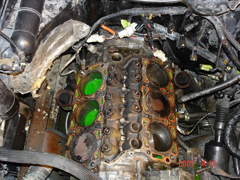

those drawings appear to suck. heres a better view:
its the whiteish round part sticking at an angle off the passanger side of the block
like wicked showed, but be careful, that is a common symptom of cam synchros goin out.
Beef
no, a failing cam syncro wont effect oil pressure at all until it completely fails...at which point you will have zero oil pressure and you wont be driving very far.
he has classic symptoms of a faulty oil pressure sender, your on the right track, jorshep.
