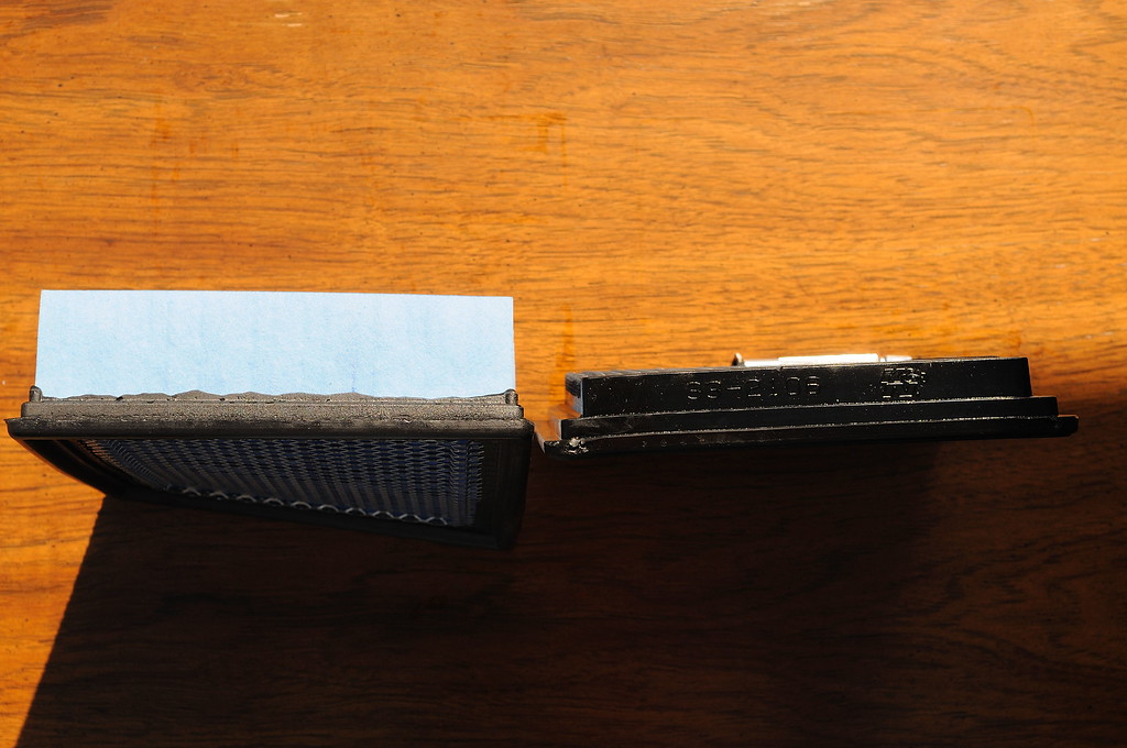

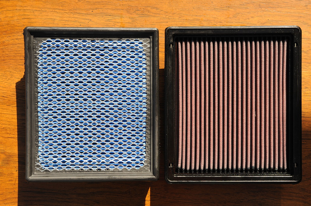

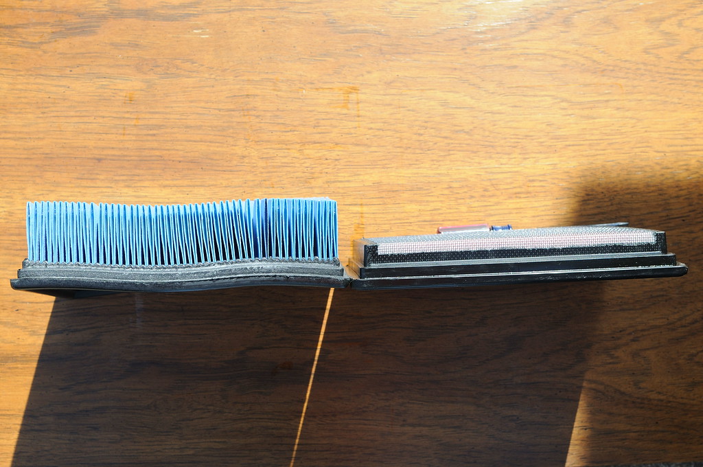

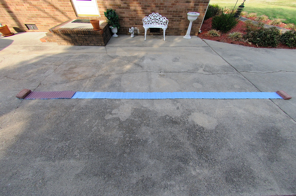

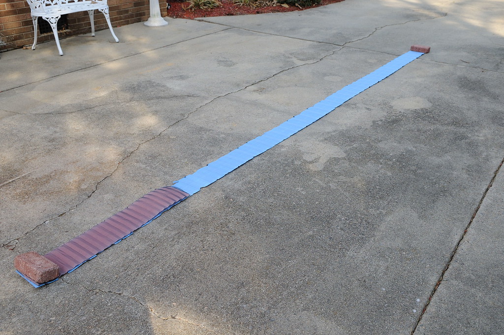

I thought it would be interesting to do a comparison of the K&N drop in air filter vs the OEM paper air filter:
Filter media comparison:
Summary: K&N filter media area = 270 SQ. " OEM Paper media area = 1485 SQ. "
People will argue that the K&N has bettering filtering qualities (smaller micron filtering).

The paper filter has 5 1/2 times the surface area, must be some big ass holes (do not want) in a k&n to flow more.

Hmm. Very interesting to see the two filter elements unwrapped and spread out end to end.

Huh? Suck a Given CFM of air through 1 square foot of filter media, and suck the same CFM through 5 square feet of filter media, which one is going to be more restrictive?
Back on topic, I have no reason to doubt K&N's claim that they "flow" better than oem because the air is obviously passing through less filter element.
Wrong assumption, the larger the filter media area, the more paths the air has to flow.....just think of the larger area as a larger diameter pipe.
