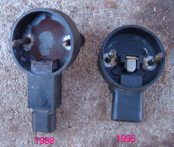

One hitch however, I left the 98 DIS in as mentioned above, however the electrical plug was physically different, so I thought no worry and proceeded to swap the cap, but low and behold the inside was different. The 95 spindle piece that passes over the sensor part was prety much a cemi circle while the 98 was maybe 1/4 inch wide. Also see the pic for differences in the cap. I did not fire it up till checking this out guys? Will I have a problem swaping the caps or should I pull the DIS and swap the worm gear and use the 95 DIS? Should I attempt firing it up with the 95 cap on the 98 DIS and see what happens?
1994 vs 1995 3.0 short block compatability
i would swap the cam syncronizer and sensor from your original motor into the new one. youll likely need to obtain an alignment tool for the job.
FYI, you can fire the motor up with the cam sensor unplugged or removed. it will throw a CEL and you will lose sequential injector timing...but it wont cause any long term damage.
