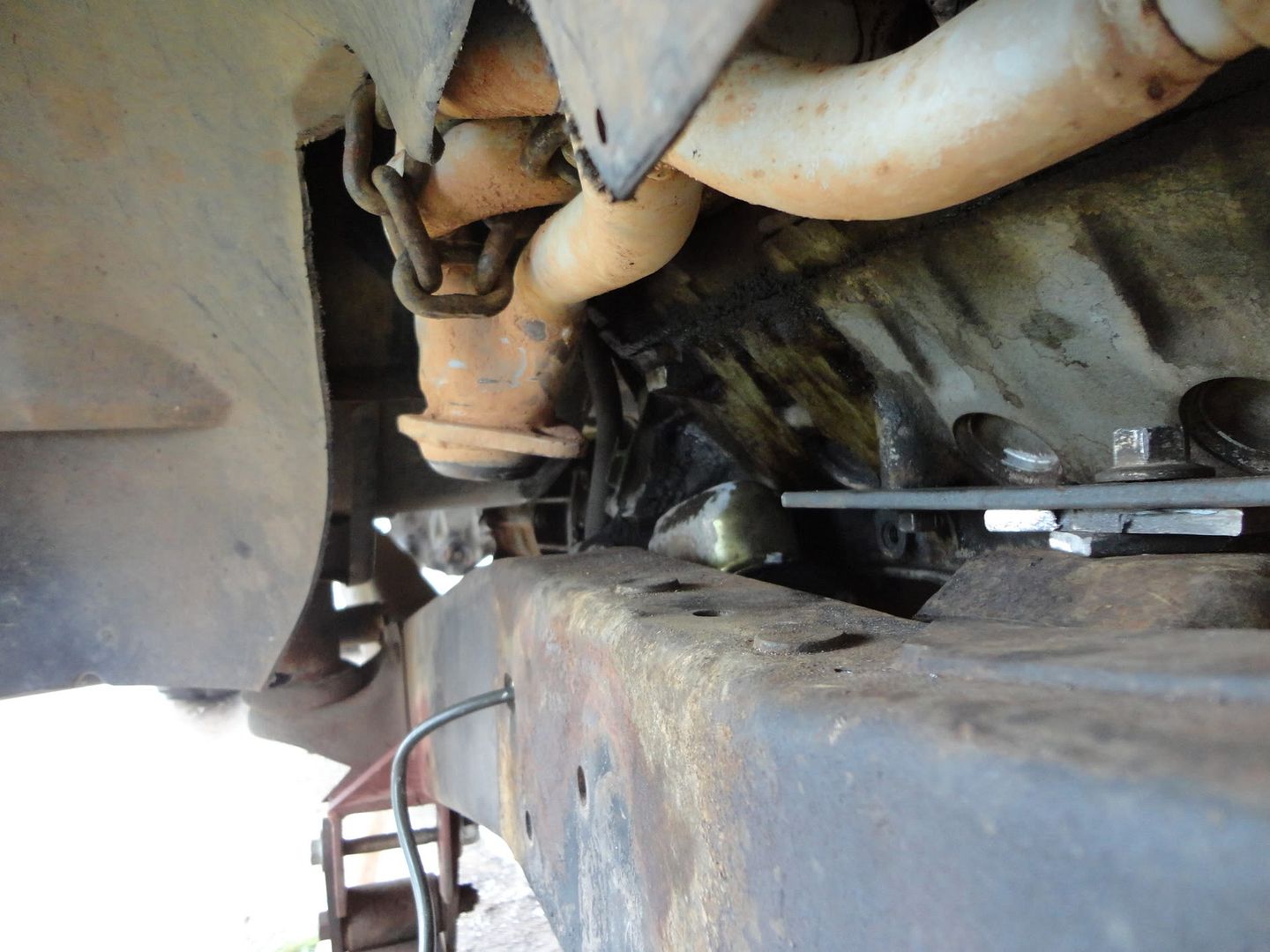

Though id add a lil info. This is from my 351W swap in my 1994 Ranger. Using these headers on a 302 would work so much better
1990 Bronco shorty Flow Tech headers fit nicely. They are a ball flange as well so no gaskets at collectors.
Driverside needs one tube massaged a lil to clear shaft on the 351. Hugs block tight and aims down along C6 tranny with alot of room to easily mount exhaust.
Passenger side angles out above the frame rail. Im going to take a small pie cut to make running exhaust better but it could work without cutting it.
