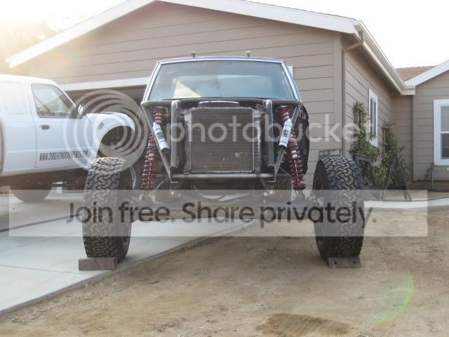

Swapping to a 2wd will be cheaper. For a desert truck it is a good idea to try to simplify as many potential problems as possible. Bottom line is if your hard on the truck you will break something at some point in time. Keep it simple and build it strong. You don't need 4wd in the desert. Build up a 9" rearend and put a full spool in it. Here is a truck I am building for a friend. It used to be a 4wd and has been converted to 2wd by using custom equal length beams.

dude that is flippin bad! thats what i need right there. you are here in socal right?
