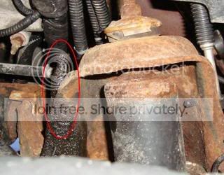

I think i'm having the same problem. Is this the part you are talking about?
Front Diff Venting Fluid...
ya thats what we have i just raised mine this morning: i need to recheck at lunch;
