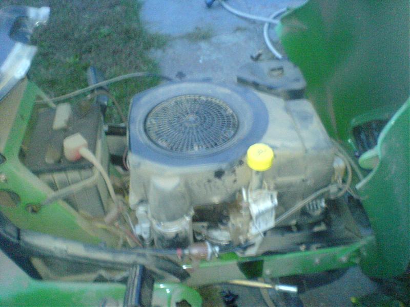

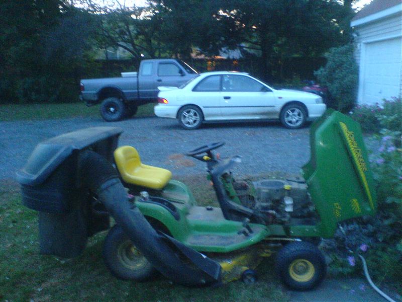

so i hadn't mowed in about a month, the grass finally got tall enough, this was to be the last mowing of the year.. instead it was the last mowing the motor will ever do...
i drove the mower to my house from next door (my grandfather's barn).. when i arrived at my house (30 seconds later).. the motor was making a bad knocking sound, so i turned it off and checked the oil, it was lowish and pretty black.. i was able to add about 3/4 of a quart before it was full.

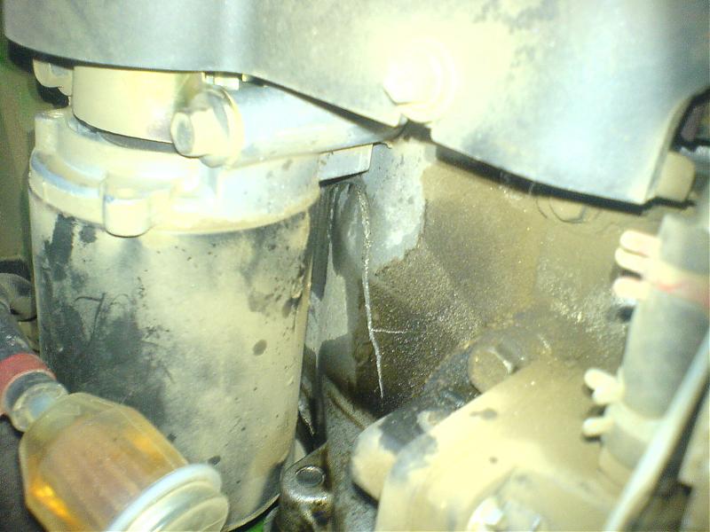

i turned it back on and the noise had not gone away. i let it idle for a minute.. then i checked the oil again and the black oil didnt seem to mix at all with the fresh oil.. i started it back up and the sound was gone.. so i went for a pass, turned it off and checked the oil, it had mixed up a bit by now and all looked pretty fresh. i started it up again and did 3 more passes then BANG.. the motor dies. cracked block it looks like..

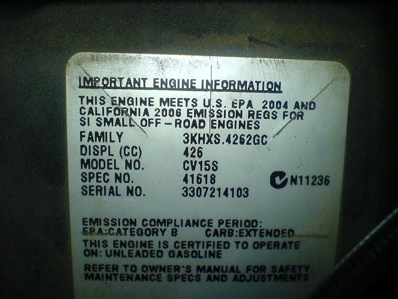

engine is a 15hp kohler.. cv15s.. ohv, cast iron cylinder liner, automotive type oil filter, hydraulic valve lifters, full pressure lubrication..
so new replacement engines i've found online are out of the question i'd say... they look to be about 700-1000
what are my options? i really dont know anything about small engines, and i know lots of you guys do. would it be worth rebuilding? we had it serviced by the dealer the first few times.. then i did oil changes every season, (checked it regularly, cleaned the air filter whenever it looked dirty.. drained the gas in the winter.. the whole mower is about 4 years old. im sure i can swap a new one in, im pretty mechanically inclined.. i just did the clutch on my subaru, i lifted my ranger, put some lunchbox lockers in the ranger.. so i might be able to rebuild this, (if blocks are even available separate)...
thanks guys

Im asuming in the only deere tech hear, i know, BIG asumption, but anyways. Thouse engines are disposable, as are the tractors. What seriese is it, 120? 130? a NEW engine from Deere is like 1700 Canadian. Id say take it in, trade it, and buy a new one. Thats my professional advice, they just arnt worth the money to fix. IF you DO want to fix it, you can look into a short block, and use the rest of your parts, but like i said, its not worth it. We only replaced a few engines, and they were all warrenty jobs.
well the mower cost over $3k new, its an LT150.. and the place my mom bought it is going out of business due to all the 'competition' around here they say.. (i now think they just suck)
this thing was just in there at the beginning of the season because it wouldn't start.. it wasnt getting fuel, thats all i knew, and i didnt have any idea how these engines worked really... my mom had them bring it in, and they replaced the fuel pump..
so yea.. its a relatively new mower, it being a throw away is kind of depressing. i guess what i'd like to do is find a used motor locally and just swap it in.. but im not sure how likely it is i'd find one..
ok, well im sorry for being depressing, and being an lt150 its a bit higher quality, i just expected a bigger engine in it. The 130's have 25hp v twins now. Seing how you realy want to keep it, i will tell you this: lawn tractors are more or less genaric, find a engine that your like, and make it fit. All you need is a 15 hp koler of the same general production date, and it should fit.

so hey ranger 5.0, what do you think caused this? it had plenty of oil when it died.. is there some sort of oil pump?
hmm, martin, you ever see how they rig up the belt drive to run a snow thrower on a mower? try somthing like that with the BII. I think the 15hp engine holds all of like, hmm. 1.75 ltrs of oil, so 3/4 was pritty low on oil...as far as the lube goes, it has to be some type of pressure lube system to have an oil filter, i dunno tho, we never tear them apart other then to get vearification for warrenty claims
