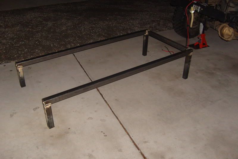

The start of the foundation:
Project: Mr. Bad Motor Scooter - 92 Ranger

Are you making the "bed" or flat section that high off of your frame :icon_surprised:? If so "Why?" I would think you would want it down on the frame, and how are you going to anchor it? Bolt on or welded on?
Other than that - nice truck
It's kind of a flatbed..sorta not really. Flatbed is probably the wrong term to use for it. Those are going to be the sides of it. The flat part of the bed will be down at frame level, but then the sides rise 12 inches for walls. It'll make more sense when I get more done on it tomorrow.

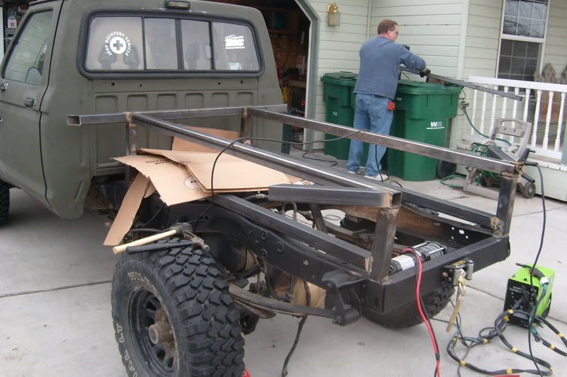

My dad was nice enough to give me a hand, which was definately helpful - notice all of the cardboard over the gas tank:
The fenders complete (minus the welding near the gas tank, it's just tacked on over there) :

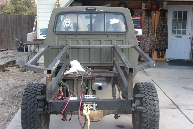

Finished for the day:
I should have this baby done by next weekend (minus the rollbar). What do you guys think of a rollbar made of square tubing? It's mainly because the rest of the flatbed is square tubing so it'd kind of match. Also, the only bender I have access to is my buddy's Harbor Freight pipe bender, which isn't really adequate for bending tube (it puts little dents in it). What do you guys think? Grac!
