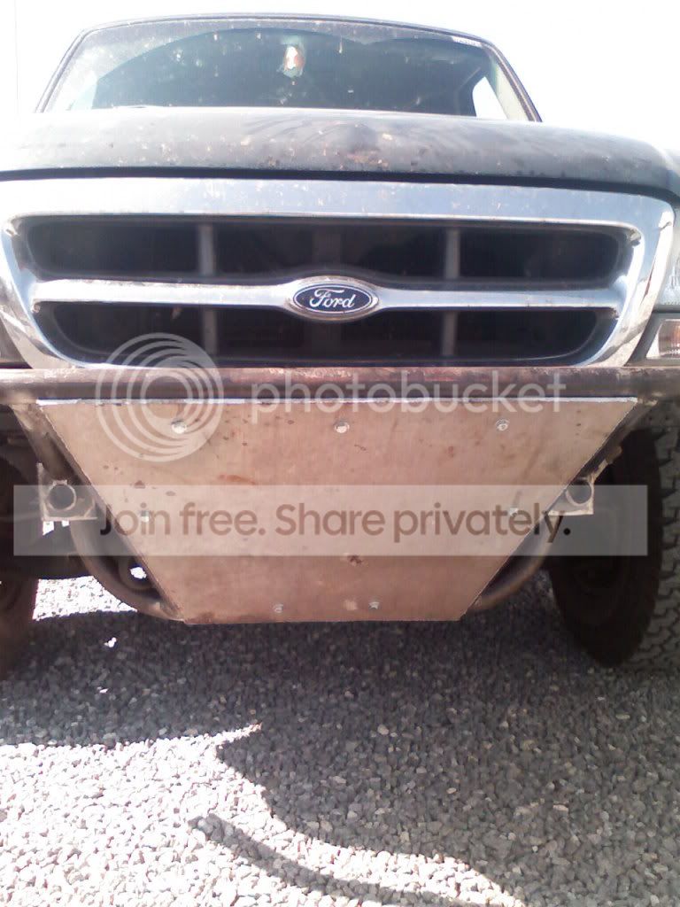

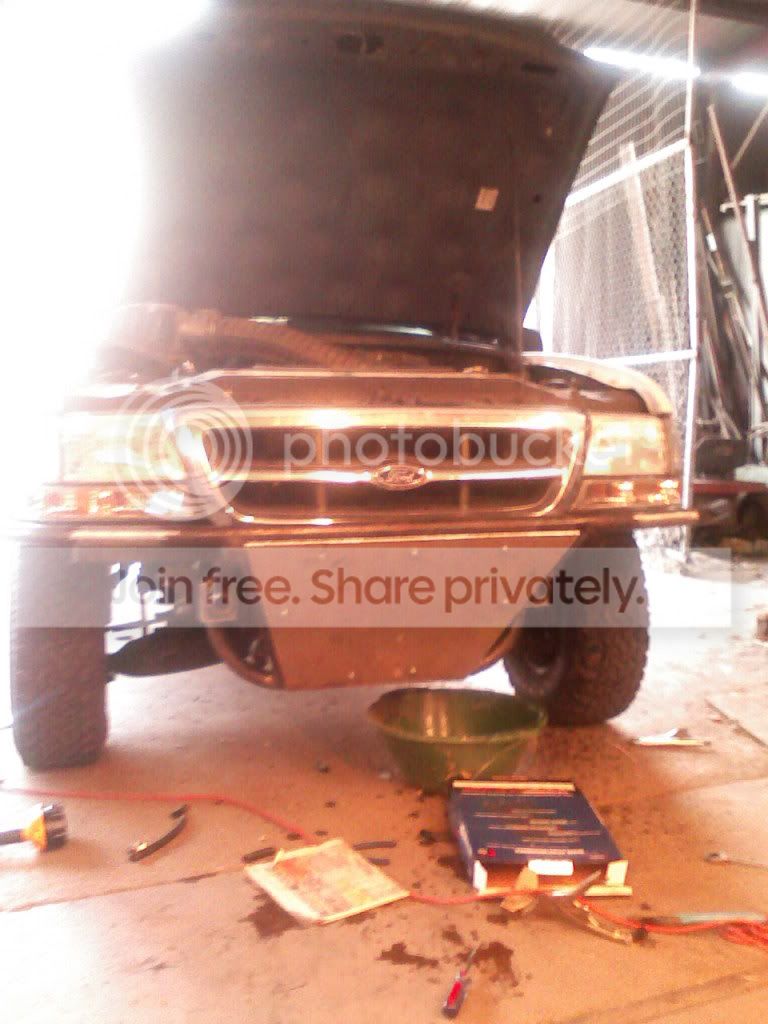

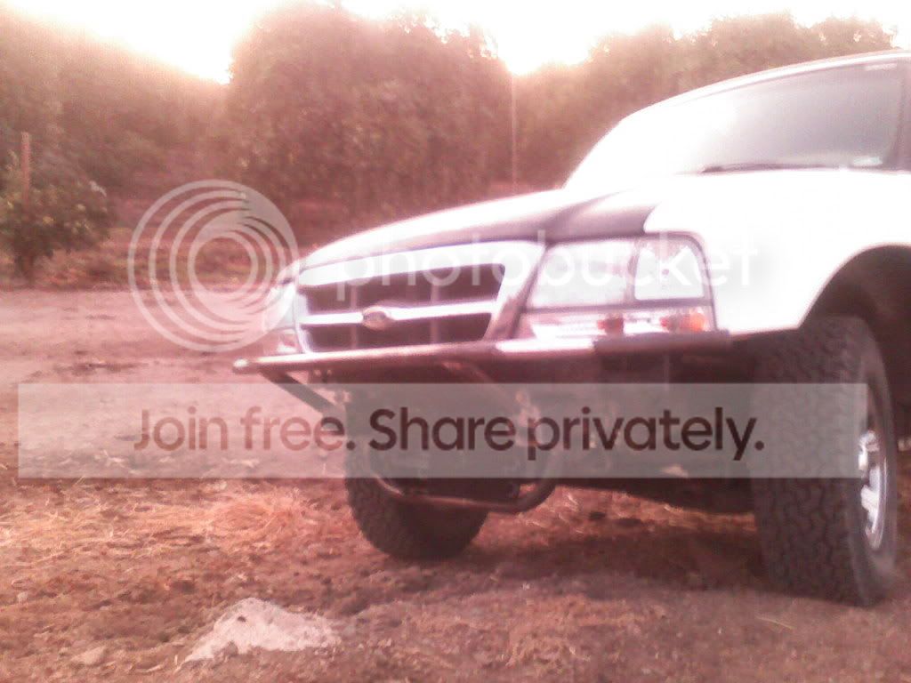

i built this bumper back in October and have not found time since then to work on it. this is what i did. every thing in this build is all mine from the cutting, to the bending, and the welding of aluminum and steel.

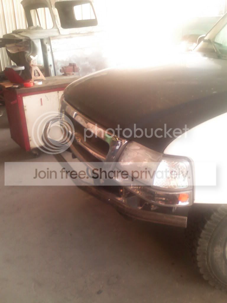

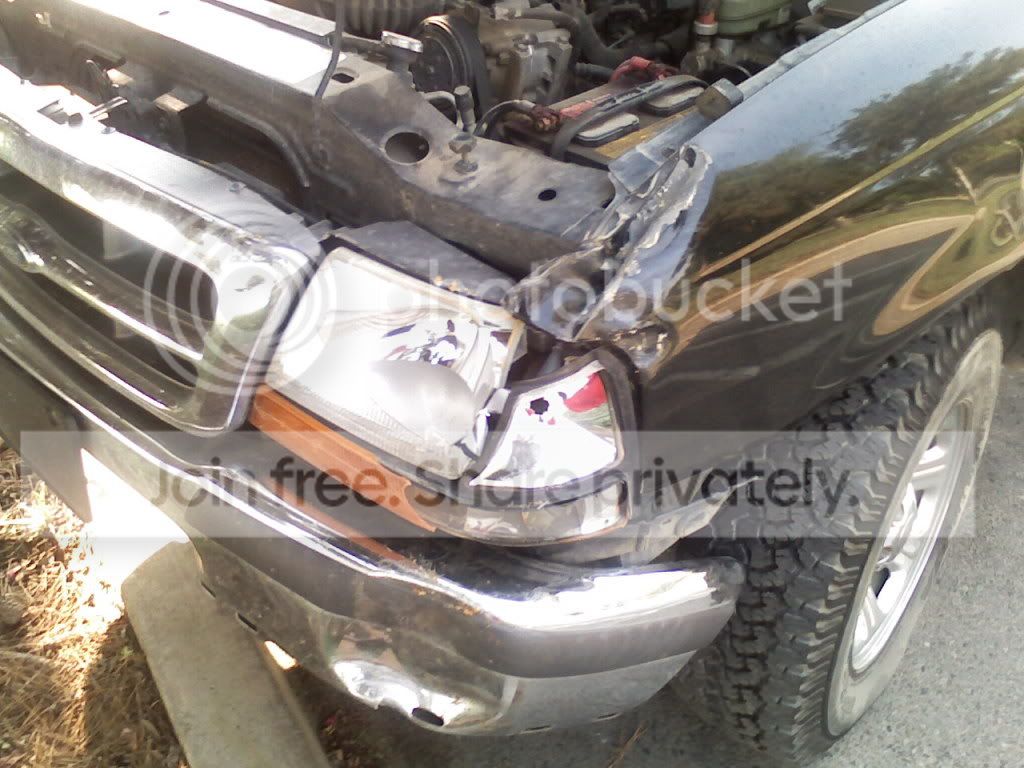

this is what i stated with. i decided to play chicken with a tree

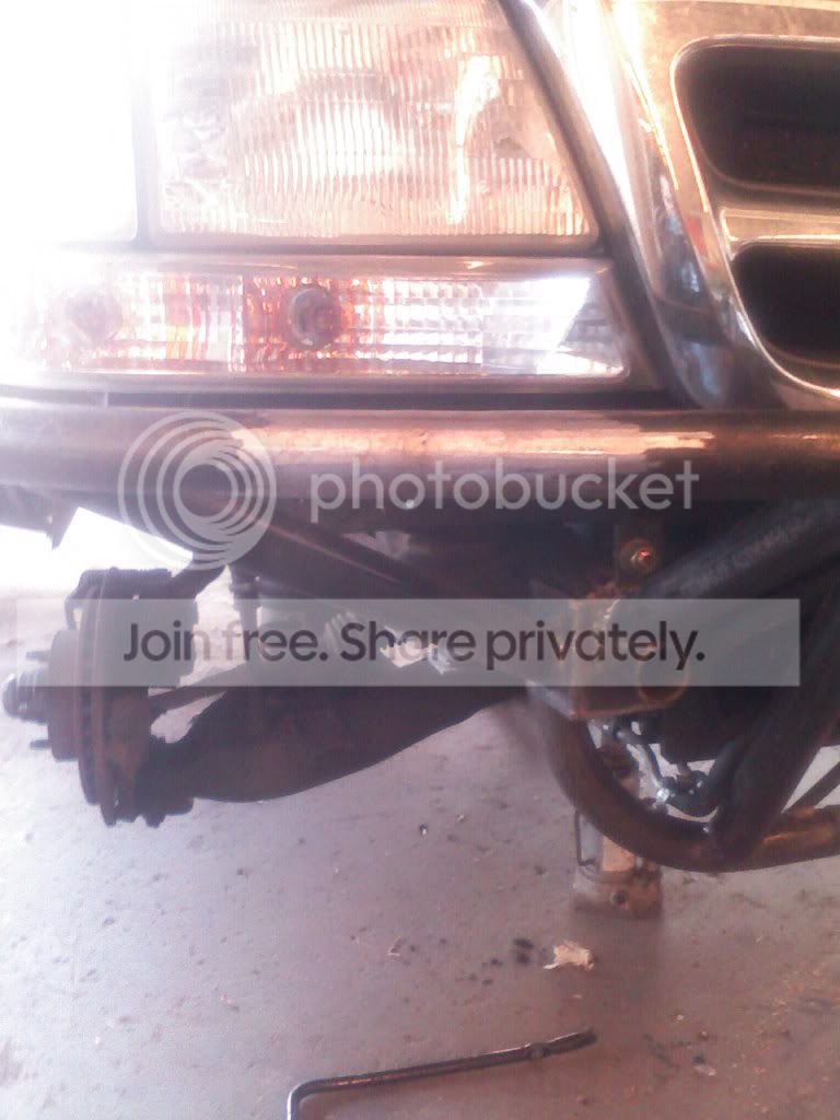

the original mounts cut. used the trusty plasma

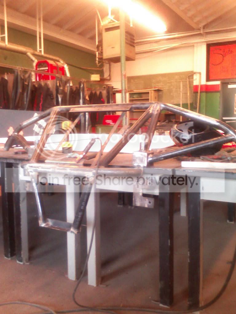

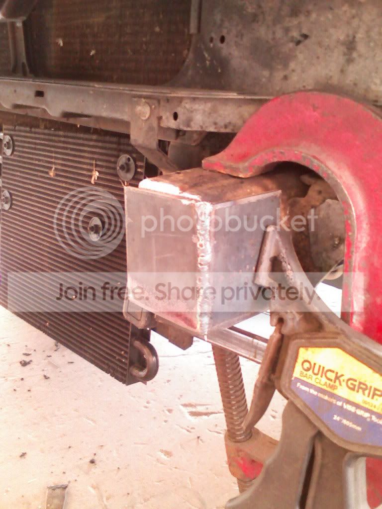

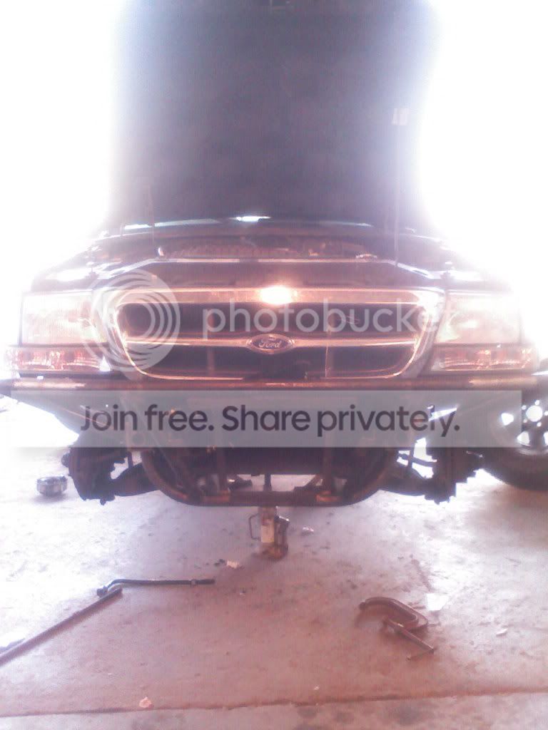

building the mounting box
tube bumper/skid plate bulid

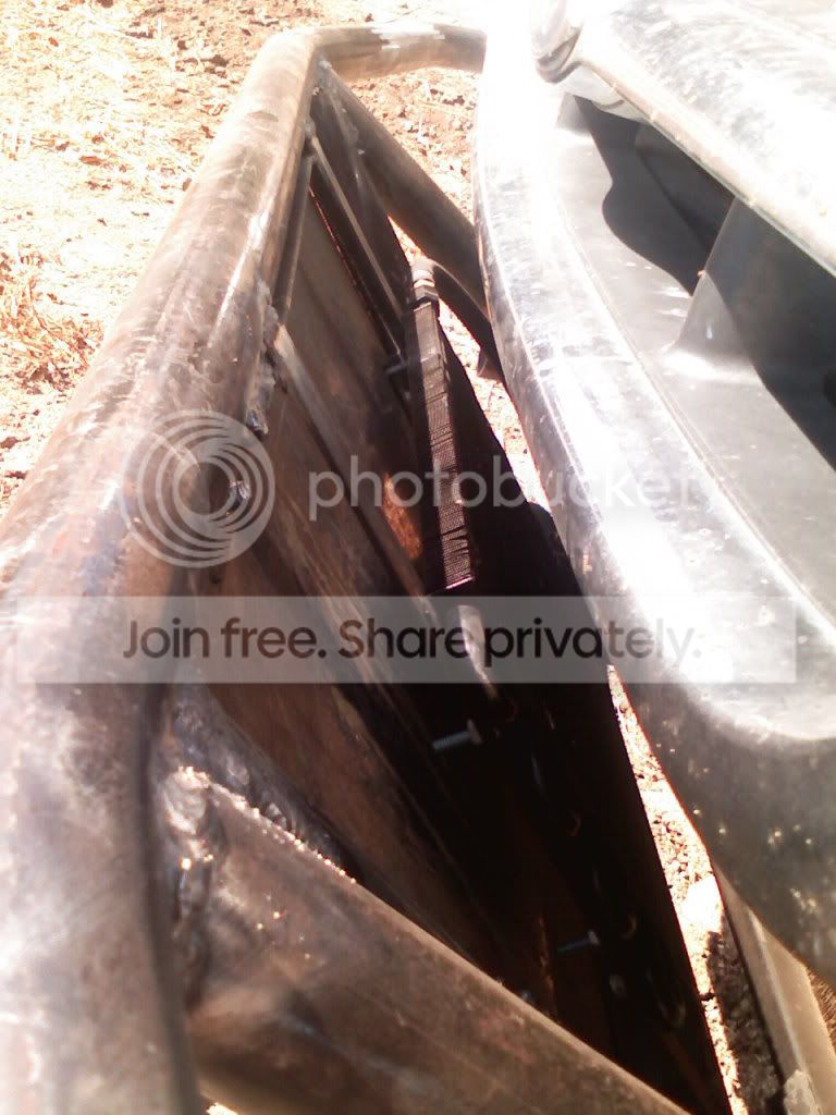

yes during this build i had to sleeve three times. one in the lower hoop and twice on the main horizontal bar.

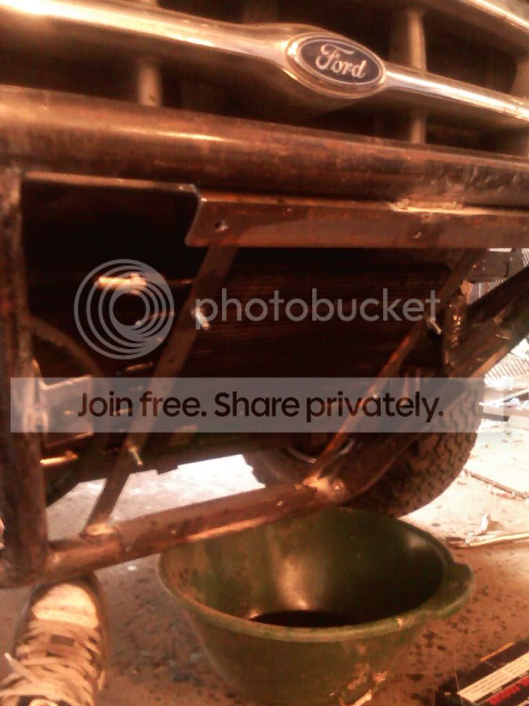

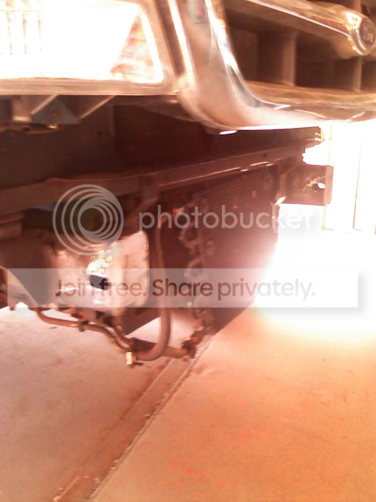

for the time being i have my tranny cooler mounted on to the bumper right now in the process of relocating it with an new cooler up behind the grill

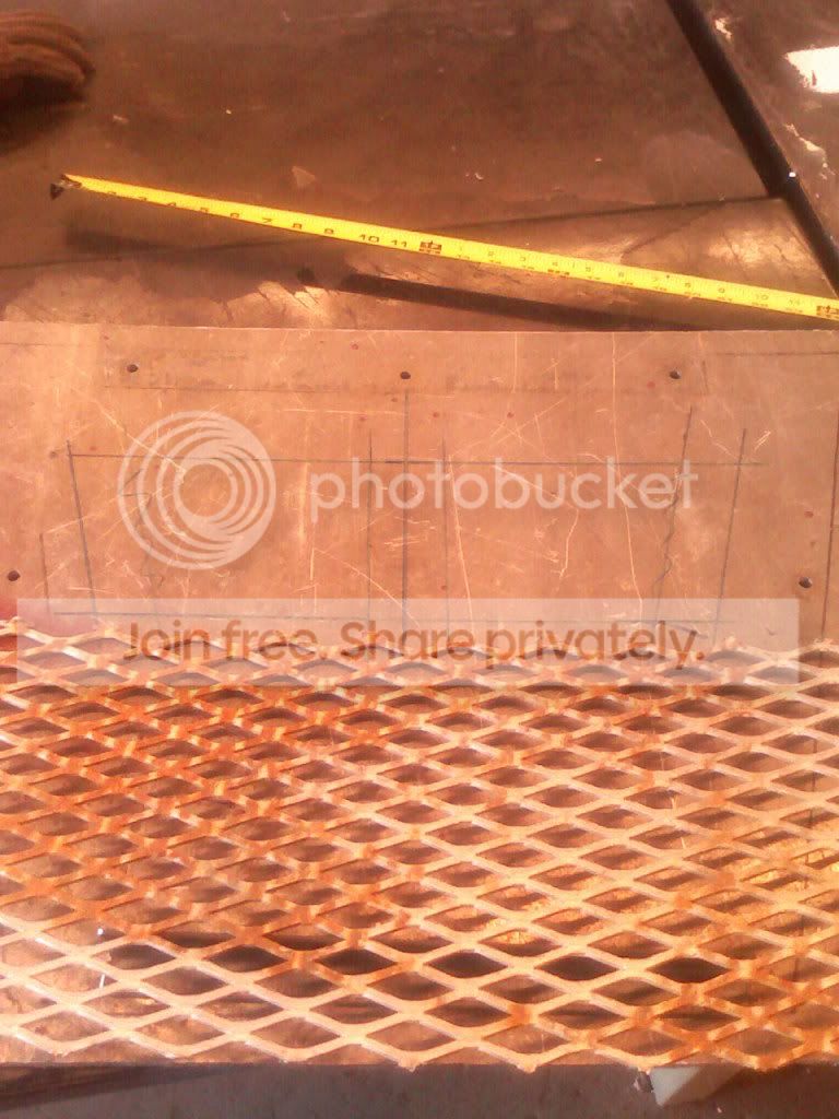

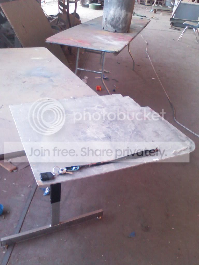

i found the skid plate in the back of my shop 1/4 aluminum
got it all cut to fit
need some air flow

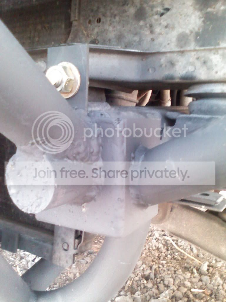

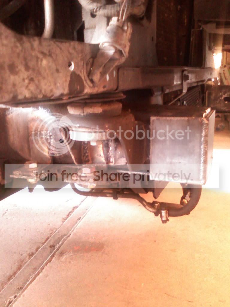

this bumper is completely removable. there are four mounting points. all the hardware is grade 8
lower mount
passenger side mounts the driver side mounts are the exact same.
uppermost mount

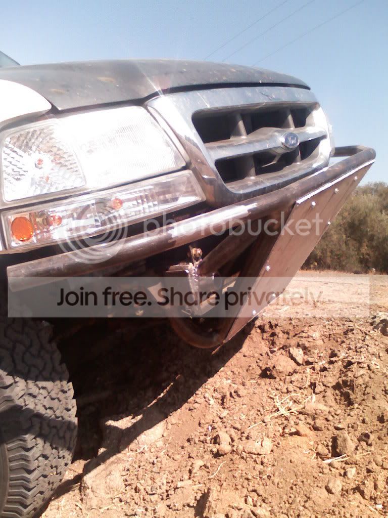

mostly done/done

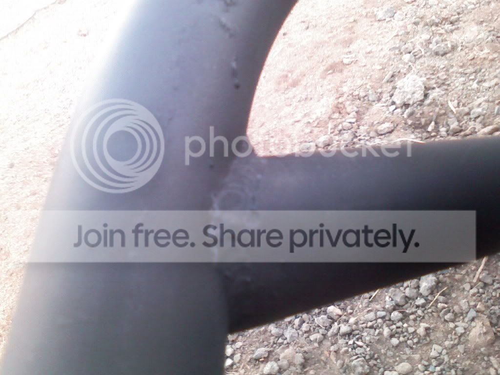

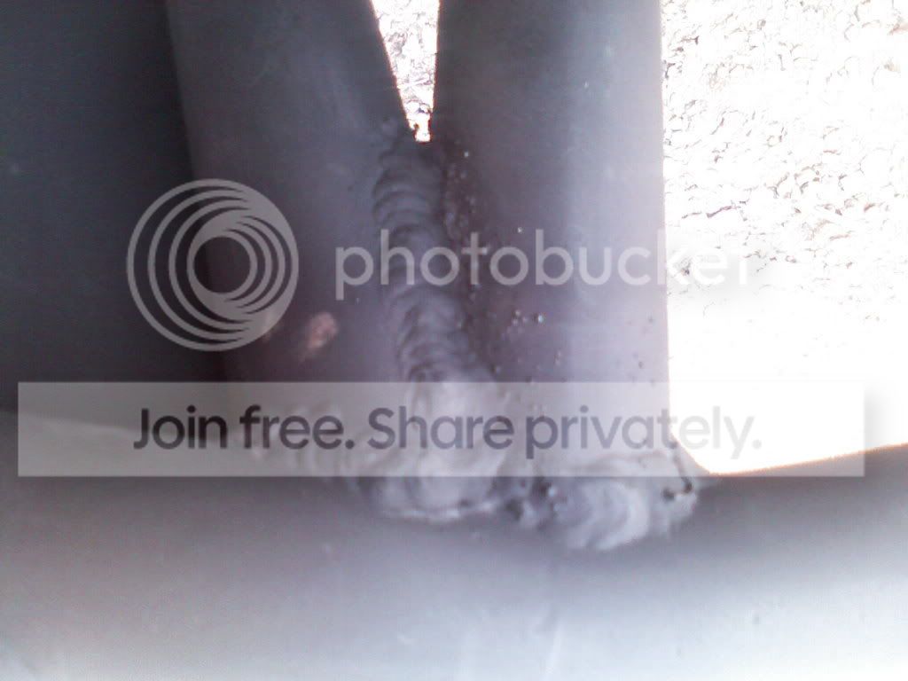

some of my welding. this was the first time i started welding after a couple years. i used the hobart 140 .35 flux wire. i run 75/25 argon/carbon mix gas most of the time but did not have the money to rent the tank or pay for the gas.

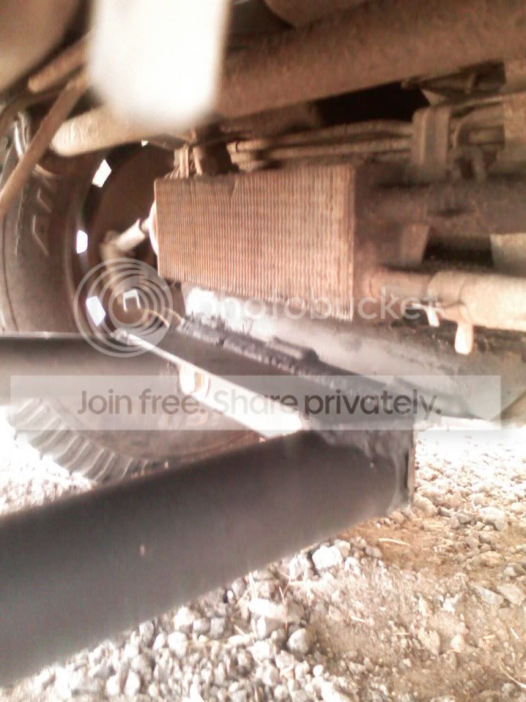

still need to add the lower skid plate.
and i plan on building another one latter on. so i am looking for froward to all the constrictive criticism so i can build a better one.

Wow that thing looks strong, how much does it weigh? :icon_thumby: to bad the cooler has to go there though. are rear bumper plans on the future?
looks great man!
thanks for the complements guys
it weighs about 50 to 80lbs and yes there are plans for a rear bumper.

looks like you stick welded it. did you?

no i didn't stick weld it. its all flux core but technically the same thing. the reason why i did it in flux is that gas and renting of the tank was ubber expensive.

Swickwake, you should have rented the gas... welds come out so nice with it, but it looks like yours are plenty strong.
P.S. you need to wire wheel them dingle berries off :D
hey the dingle berries give it that costume look
i totally wish i had the two hundred bucks to rent the gas. i love the way my welds look with the 75/25 mix. supper clean and no DINGLE BERRIES!!!!! :icon_thumby:

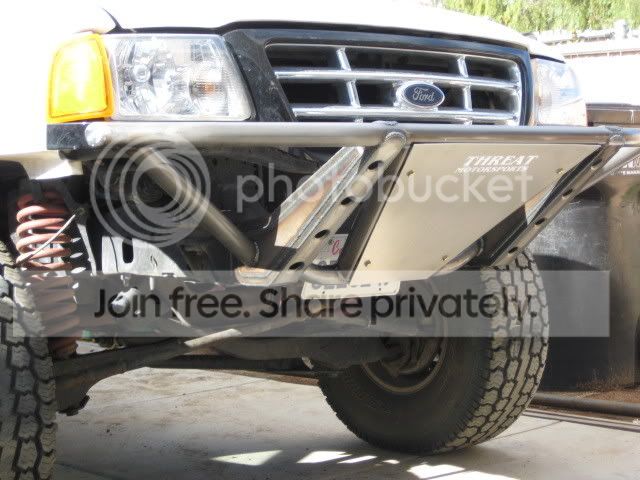

Cool bumper! You should be able to sell them for right around $200.00 or so since material has come down again. Here is one i made for a friend a while ago with fully boxed frame horns. If you make custom frame horns it really speeds up the assembly time. Especially if someone wants tube placement in different locations like my buddy did. I made this one in about 2 1/2 hrs. Keep up the good work its looking good!
^^^^ a complement coming from some one who is in the industry i really appreciate that
way ahead of you on the design. right now i am creating a jig that will allow me to be able to have custom placement of the main horizontal tube.
are there plates behind the upper mounts? Im having my buddy design me one and i have no idea where to put the mounts. could possibly post some detailed pics of the mounting brackets?
