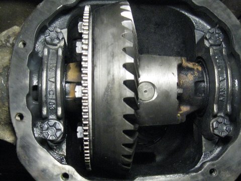

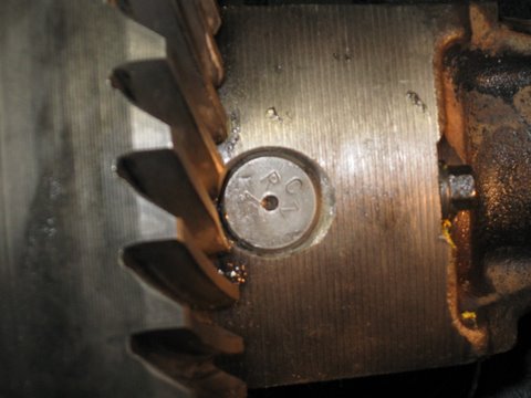

I have a lockright with the 7.5" 4.10 gears. The ring gear comes right up to the edge of the crosspin hole, when I installed the locker I had to grind a small amount off of the corner of the teeth in front of the hole to get the crosspin out, the crosspin had to come out to install the locker. The 4.56 gears will have a thicker ring gear that would cover the crosspin hole making it impossible to remove the crosspin without taking the ring gear off the carrier. As long as the locker was installed before the 4.56 ring gear was installed on the carrier I think it should work, as long as you never wanted/needed to remove the locker. See pics of my 7.5" with 4.10 ring gear and crosspin.
I think the reason the powertrax web site said 4.10 and lower was because the locker is advertised on their page as "Installation is simple because no ring and pinion set-up is required. In addition, no special tools or oils are needed" this would be true for the 4.10 and lower numerically but not for the higher gears numerically such as the 4.56 you are looking at due to covering the crosspin hole, requiring the ring gear to be removed and set up again which would take more tools/know how that most people have.
I hope this helps, maybe someone that has installed a lockrite or no slip in a 7.5" with a higher ratio than 4.10 will confirm this.

I'd just grind the gear so the pin can go past it. The pinion doesn't make contact at the very tips of the gear teeth anyway, so it's not likely to affect the strength of the gears at all.
