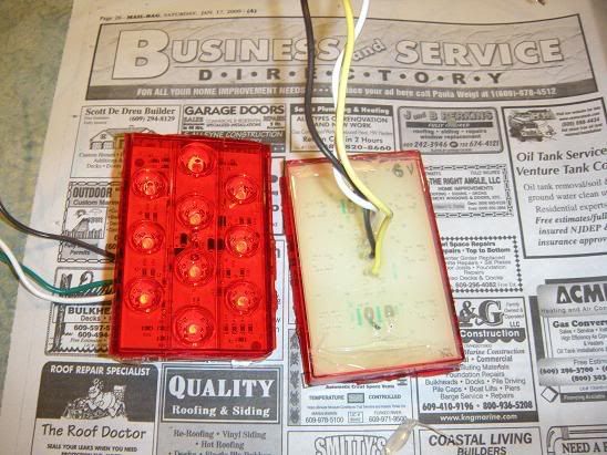

you can also see the trailer replacement walmart 24$ led panels. I forgot to take pics of the lights before i hacked out the LED board.
08' FX4 LED tail light retrofit w/ trailer parts!
LED board ready to be mounted up.

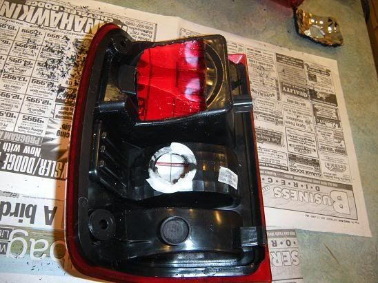

In this picture you can see the tail lamp cut out in the rear to aprox 2.25x3.25inches. I used a rotozip to cut out the rear of the reflector with no problem at all.

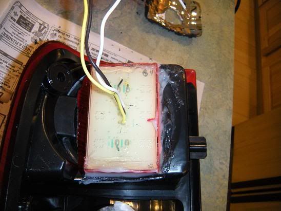

Here is the Led board mounted into the rear of the housing. Its a friction fit but i used Fusor Plastic body panel welder for installing flares/panels in body shop application. i think it will hold.
Here's the pair of them after 24 hours dried and ready for installation. The 3 wires will be soldiered the factorry tail light harness after the plugs are cut off. I will also be installing some 15ohm- 50w resisters to slow down the blinkers. Not seen in the picture.

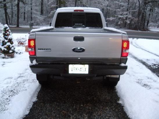

Running lights with them on the truck.. I like the look you can definitly tell there LED, also the blinkers have that trademark snap on/off Light output. it just looks sharper than a bulb would.
