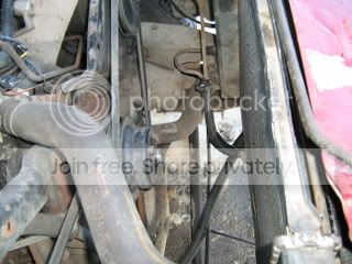

I need to replace my cooling fan since the clutch was shot. I use a e-fan from a dodge mini van(free). So here it is.

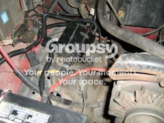

I used a relaybox with a diode from a 94 Areostar. Also installed a 3 way switch so I could have off/low/high for my fan.

It works great and it was all free. It was also a good project for doing a neater job. This summer im thinking of 3.8 cfi on my 2.8l. Now I also have heat in my B2 @ -25-30c. All and all it was a fun project.
